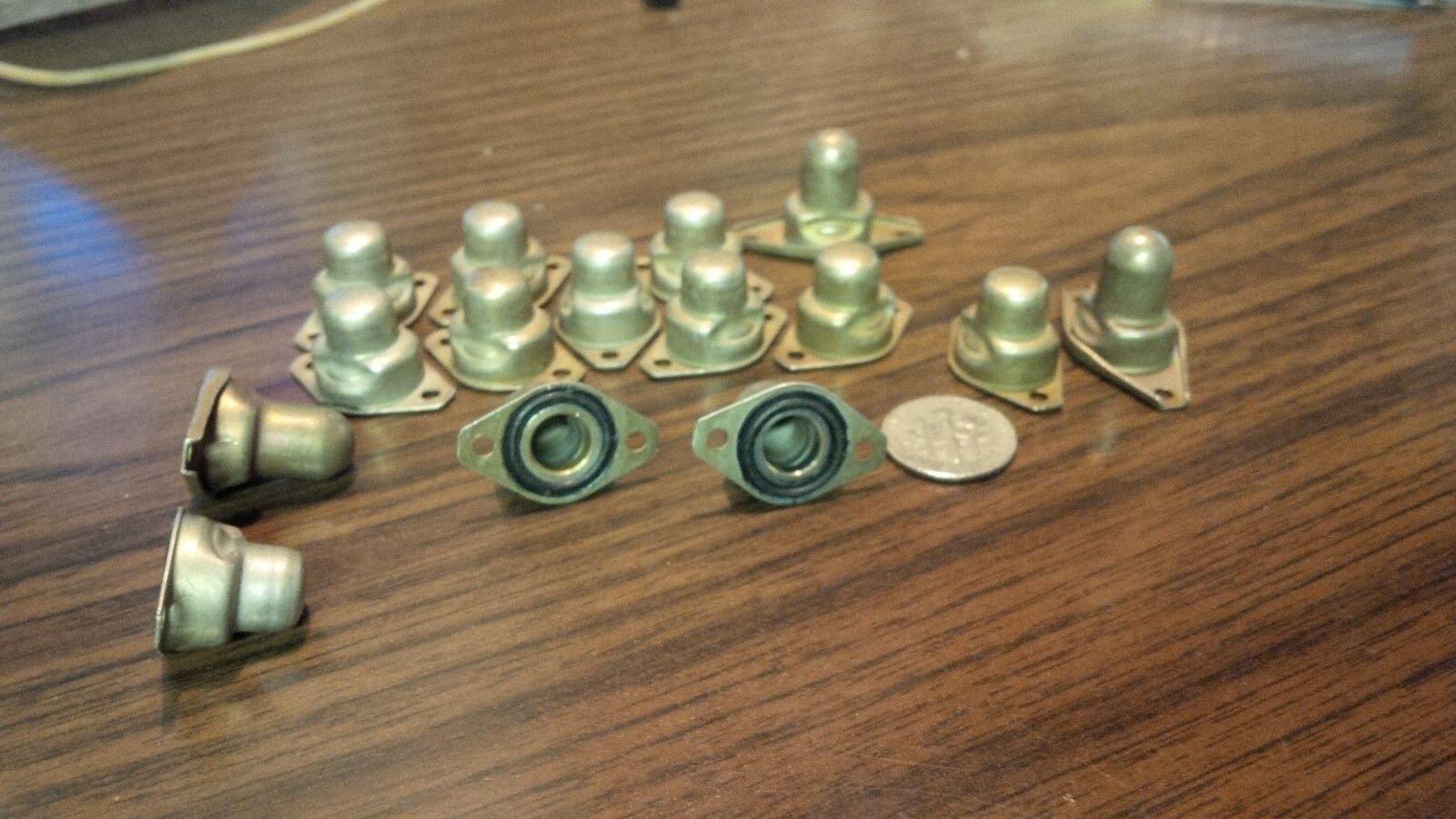

$330? Is that a pair or each? Are they made of gold? That’s crazy..I just ordered 4 nut rings from AirPower for less than half of that for the fear that AirPower will see this and up their prices!!
Just heard back from CiES. $330 is for two. Yikes. Gonna order the AirPower nutrings instead.

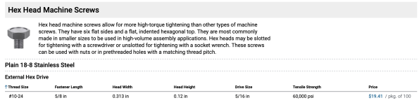

Those look really, really nice, but... there is no conceivable advantage that they could possibly have over the other ones and you're never going to see them (hopefully) ever again after you close the tanks. Note that the other nutrings are secured with 5/8 10-24 hex screws, and this requires the standard holes to be enlarge (I bet the CiES ones are similar). I bought stainless steel screws from Grainger, it's kind of an odd size and I couldn't find them elsewhere.

That's great information. Are these the screws you used?
!View attachment 64019
I’m not a fan of stainless screws.. stainless are brittle and seem to cause the alumInum to corrode around it. Ever snap a stainless screw? They are hard but seem to break without warning. I would look for cad plated and cut them down if I had to, even thought that cuts though the cad plating at the end.

Walt also posted a solution of sealed nutplates that were cheap.. $11 for a bag of 10 I think? The benefit of these rings though is the rigidity of the whole thing. It won’t “pillow” around the screws. Probably both work (and have)
I was thinking about that. One of the nice things about the nutring is you can change the screws without any issues.
