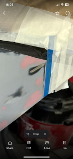

I feel like I need to scrap my whole canopy…
I’ve been working so hard to get a nice edge to my fibreglass fairing, remove the last layer of tape and found this.
I’m very worried I’ll come out on Christmas morning to find my canopy cracked in half.
Is this a massive problem? What do I do!
It’s the only place on the whole canopy as far as I can see - this one fastener was tightened the same as all the others.
There looks to be 3-5 tiny cracks. I can’t feel them on the inside or the outside with my nail. The longest is 1/4” long.

I would at least try to stop drill.
Do so immediately and see what happens in the next few days.
I worry since there are 5 “fingers” that drilling the ends of each will make a little seam of holes. Maybe worse than the cracks.
What resin did you use?

A stress of some kind at that point. What Jim said.

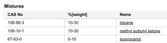

I did use some of this on the outside surface. Perhaps this is crazing from the solvent? I used this in the corner to fill some pinholes etc.

It has the classic appearance of chemical induced crazing, which is the reason I asked.
There is a high probability that the filler is what caused it.
Bloody hell. Thanks for the advice.
That might explain why I can’t feel it on the outside or inside?
How would you proceed? Does it need stop drilling? Would weld on 3 work at all? (Maybe not since I can’t feel a crack on the outside for it to wick into)

Back away from the edge....beep beep beep. No seriously take a breather. Don't put a drill bit anywhere near it. Just keep finishing up the canopy and don't try forcing a fix.
If its those striations I'm seeing near the bottom of the picture, you can decide later depending how long they are to possible scuff the area and put a nice coat of paint similar to what some autos have on their front windshield or a thin piece of vinyl wrap to clean it up. Some painters will run a finish bead of proseal around the canopy perimeter after paint.
Otherwise I would not do a thing right now. That crazing if thats what it is isn't going to grow on you.

Here is a photo showing where I used the blade putty in the corner to try and add a tiny bit of thickness - it’s the pink stuff. It was put on above the tape and sanded down - under the tape is the bare canopy. I ended up sanding most of this off and using micro in the end to get a better edge. A stupid thing to do -
Scott warned in his videos to be careful what you use. I had used this plenty of times on fibreglass to fill pin-holes. But there was bare acrylic underneath. Rookie error. Idiot!
Uhm, erm...I respectfully disagree. To me, that looks like the adjacent hole wasn't drilled and upsized a bit to allow for expansion, and/or the hole wasn't deburred/finished to a high luster.
I would loosen the adjacent screw by 1/8 - 1/4 turn to take some of the pressure off the hole. Dress the window edge with proseal or equivalent when you get the plane painted.

I think you are ok. Soon after building, my 7A canopy developed some tiny cracks in the forward left and right curved areas. Multiple tiny crack looking lines all within about an inch. Like you, I really could not feel anything and definitely didn't stop drill. The only thing I did was to saturate that small area on each side with thin super glue in hopes that if there was even nearly microscopic access, the glue would wick in and stop any further spread. That was 11 years ago and no changes since. Don't even notice them as they are at best even with the top of the rail. More visible from the inside. BTW, my canopy was placed using only screws.
I have seen a number of RV with such cracks in that exact place. I believe it is due to tightening the screw too much which is on the sharpest curve of the canopy. Use some Weld-on #3 and perhaps extend your fiberglass fairing a bit higher to cover it. Most that I have seen did not grow beyond the initial crack.

Firstly, thank you to all that took the time to reply. It’s 0530 Christmas morning now, and kids are still asleep, and I’m in much less of a panic - mostly due to the support and messages from this forum (and a couple of bourbons). I checked under the tree, but Santa didn’t bring a new canopy for me. Seriously though, appreciate the assistance from everyone!
I have put some tiny sharpie dots on the ends of the cracks to monitor them and will build on. I’ll order some weld on 3 and see if I can wick any in at some point or other - maybe from the screw hole itself with the canopy upside down. Add it to the little jobs list.

High probability:
It was a stupid thing to use - it’s easier than Bondo because it’s single part, and can be sanded in an hour. Great for pin holes and small imperfections. Usually…

I disagree as well
Pretty much every single RV canopy installation has some level of strain built into the canopy once it is installed because they are not 100% perfectly molded to the net shape of the frame.
This is not ideal, but it is what it is, and in most instances if proper install techniques are used, it won’t end up being a problem.
When an issue does occur that was related only to induced stress (such as improperly, finished edges, or deburred holes), it pretty much universally results in a single crack.
In this instance, the stresses were relieved at a micro level on the surface of the acrylic because of the influence of chemicals that react with the acrylic which causes spiderweb cracking or what we also referred to as crazing.
I have seen the results many times. The outcome is generally the same and the same cause…. Some type of aromatic chemical/solvent reacting on the surface of the acrylic (where the stress is actually the highest) and causing the crazing as some of the surface tension is released.
Probably not a structural concern, other than now that the process is started, that area may be even more susceptible to future damage so great care should be used regarding what solvents contact the canopy in that area.
Bondo filler contains polyester resin and MEKP which is also kryptonite to acrylic plastic, so it also wouldn’t have been a good choice.
In the video, it mentions that it can be used for filling, small voids and depressions if you choose, but it should only be used in locations that are well away from the actual acrylic canopy.
I have done this many times myself for the same reason you did, because I was pressed for time and needed to do the final finish work ASAP, but always while using extreme caution to not be near the acrylic.
The safest filler is to use the same resin that the fiberglass layup was done with, thickened with micro balloons.

Though if the cracks weren't visible prior to beginning the layup work, a chemical influence is likely still relevant.
The cracks are most definitely inside the acrylic - they don’t seem to extend through to both sides - I can’t feel anything on the surface with my nail on either side. Could they be internal only?
I am unfortunately unsure when they occurred - we tightened the nuts on the airframe, then moved it over to the bench. When we tightened it, it already had the tape layers on the canopy. I wasn’t happy with them and removed and replaced the tape with the canopy on the workbench before starting fibreglass work, and never noticed the cracks with the tape off. Perhaps they occurred due to temp changes while it was on the bench? Or perhaps due to the filler?
Tracing the trajectory it seems the cracks extend back toward the hole? Maybe? (see photo). Maybe this one wasn’t deburred as well as the others (although I thought I took good care with every one). As far as my exposure to different RV’s, of the canopies I have seen cracked at holes, generally seem to always be a single crack. This is more of a little web - albeit extending back to a single source maybe.
Anyway - it’s happened. The cause is a bit redundant at this stage. What to do about it?
I was thinking, once the fairing was complete, of turning the canopy upside down and seeing if I can apply some weld on 3 using a syringe into the hole? Perhaps, if I’m lucky, it would wick into the cracks?
If they are indeed due to an over-tightened nut, do they need to be stop drilled? I’m not really a fan of drilling 5 tiny holes and hoping I hit the ends of the crack.
I’m also thinking of backing all of the nuts off a little bit. When I tightened them, I took them until just snug, then went a 1/4 of a turn more only. This seemed about right to me. Wasn’t sure how tight they were supposed to be. The plans warned against over tightening of course but didn’t give a torque value.

Just to share, I have had a really good experience/result with Weld-on #3. It is super thin and wicks thru easily. While you have it open, it would not hurt if you put some on that portion of the countersink just to give it a bit of strength if it is a crack.
Just want to circle back to your comment Scott.
I installed a screw and nut into a hole I had countersunk in my scrap canopy piece, when setting the depth of my cage. I tightened it to snug, then a quarter of a turn as I did on the real canopy.
It did not crack at all when installed.
I then taped off a small triangle with the tape over the screw head, as it was on the real canopy and smeared on some blade putty. It was probably slightly closer to the screw hole in the test article than the real canopy.
Initially the blade putty had no effect on the canopy at all. It looked fine. See first photo.
I let it cure for an hour or so, then went out to sand it smooth and your initial comments were spot on.
There were radial cracks, emanating on the surface of the canopy, from what looks like the apex of the countersink cone. These all seem to be on the surface. A small distance away from this, are larger cracks which seem to be inside the canopy glass itself. I cannot feel these larger cracks on the surface. They do look like they extend through the thickness of the material.
Suffice to say, I think I have replicated the issue totally.
Interestingly, I had applied some filler in a second area of the canopy scrap, adjacent to a countersink, but with no screw installed - the filler had no effect at all. So what Scott said seems spot on:
At least I know it wasn’t my ham-fistedness with the spanner, but my decision making with the filler!
The scrap piece will at least now provide a test article, to see if the weld on 3 applied to the countersink will be beneficial.
Will report back on that when I get some next week.
