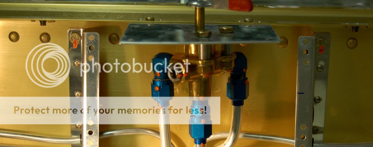

All this stuff in the tunnel of a 10
Leak at fuel selector
