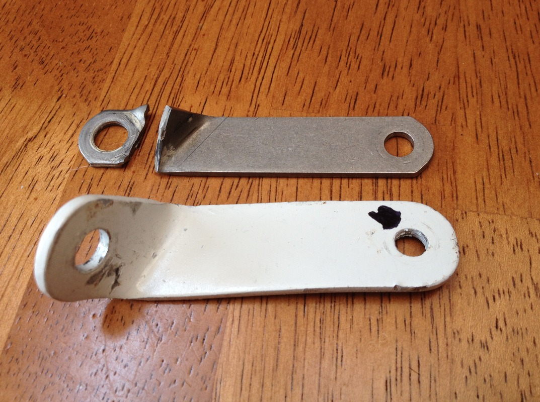

During my annual inspection I caught a broken bracket under the ignition module. I caught it by chance just because the vibration had created a polished crack that reflected my torch light. Very tight place, no easy access for repair and after finding how this bracket was made originally by Rotax (by bending 90 deg a pretty thick piece of Al), I decided to fabricate one (out of an Al angle) that should be less likely to crack. I suspect that I missed this broken bracket at my last annual because it was not polished enough... :D
Here is the faulty bracket with the new one I fabricated:

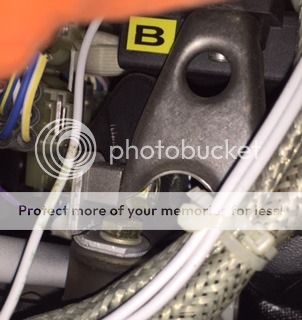

Here is the location where the bracket can be inspected (the new bracket shown here after repair):
You can easily understand why this cracked bracket might be difficult to detect (although I found afterward that pulling the ignition module up will show the crack once the bracket is broken)

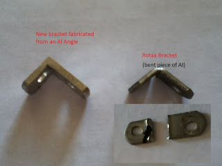

I see two possible issues with your new bracket;
1 - It looks like it is not the structural Al angle, no radius in the inside corner
2 - There appears to be a notch in the inside corner of the new angle, which may be a new failure point.
My questions are only based upon the image and may not be accurate.
My question, is an aluminum angle as strong as bent aluminum? Maybe it is stronger? I do agree the angle in the picture does not look like structural angle.

I fabricated the bracket in my hangar from an angle scrap. I had to shave some material to provide clearance for the bolt head. It's quite possible that there are some weak spots. One sure thing, I will keep an eye on it and if it fails I will know how to make the repair.
Maybe it's just me, but given the long term performance of aluminum under vibration and flex loads, I'd be more tempted to make a replacement from stainless or maybe primed/painted 4130 sheet. AL seems to be a less than ideal choice for a mounting bracket like that. But I'm no engineer, so don't take my word for it.
Seems like the original bracket probably had a lot of residual stress from forming the 90 degree bend. At least the extruded angle used for the repair won't have that. I'm not a metallurgist, but any metal is subject to fatigue effects.

Yes it looks like decorative architectural angle. It will likely fail as well. Structural angle has a generous fillet which will improve fatigue life.
I do not believe you need a structural angle here. The ignition boxes are light and stacked on the angle, they are also supported by two rubber dampers on the opposite side of the bracket and the bracket itself is attached to a third rubber block. This is probably the reason Rotax chose to make the angle out of a bent aluminum bar. It is why the broken brackets are difficult to detect as there is no consequence beside a rubbing of the two broken pieces of the bracket. I suspect the original bracket failed from the thermal cycles, not under mechanical stress.
I agree. This seems like a low usage application. My guess is the failure is due to high residual stress from bending, more than in service cycles.

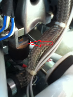

additional item to check?
While replacing the broken bracket I lifted the coils beneath the ignition modules and found the powder coating worn completely through (located at the end of the red line).I primed and painted this small area then used a washer at each end of the coil attachment to shim vertically and prevent further abrasion.

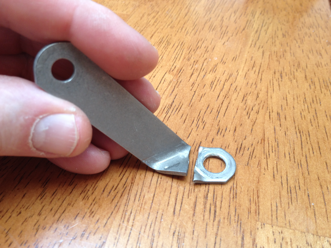

Thanks for your original post. I am doing my fourth annual and found this issue. It must have been broken for a while because the vertical part of the broken angle had sawed into the head of the 10mm bolt that fastens the horizontal part of the angle to the rubber shock isolator.
FYI I checked the original bracket with a magnet, and it is non-ferrous, probably aluminum, which is what I replaced it with. I think the problem is that the bolt holes in the angle are offset, and if the offset is not correct there is a constant force pulling the angle causing it to fail.

It looks like most ignition mounting bracket failures are the stubby 90 degree brackets on the back of the ignition coils. I have not had this failure, but now at my latest oil change (325TT), I noticed the long front bracket has failed just below the 90 degree bend. This is PN 29 in the attached drawing. The bracket is 0.080” Stainless Steel. I have fabricated a new bracket from 1/8” mild steel and added 1/8” to the overall width for additional strength.
Attached photos show broken bracket and 1st iteration of new bracket to test fit. A second more professional bracket is now installed on the engine.
