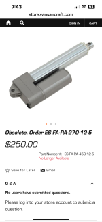

Change to RV-10 Retrofit Flap Motor?
I can't say with certainty, but I surmise that both parts are the same dimensionally, but ES-FA-PA-450-12-5 has a 450 lb load rating motor, while ES-FA-PA-270-12-5 has only a 270 lb load rating. I suspect both are suitable.
The official answer from Vans is that ES-FA-PA-450-12-5 ran too slow, so it was replaced with a faster motor (ES-FA-PA-270-12-5).
I've noticed ES-FA-PA-450-12-5 in my plane runs painfully slow.
