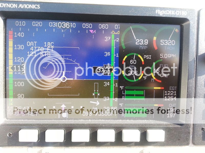

My EGT readings - -
A little faster than I usually cruise. About 66 degrees OAT. This is about normal for mine.
I don't know that I have ever seen EGT readings above 1250 or so in my RV-12. They're usually around 1180 - 1220. The biggest different L to R that I have seen was a little under 50 degrees, they're usually within +/- 25 of each other.
