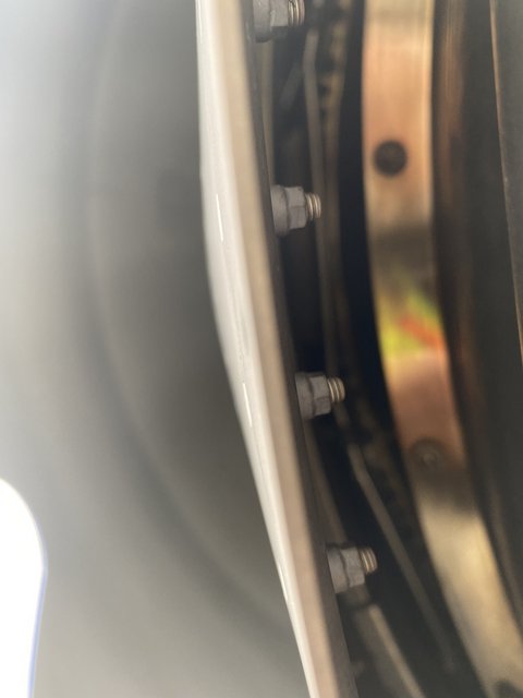

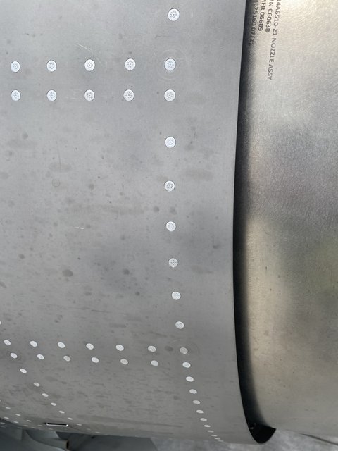

Anyone know what fasteners these are? These are located in aft section of a turbofan. Clearly high temperature fasteners, but the heads look like rivets whereas the opposite sides are threaded with nuts. I’ve never seen anything like this before.
Looks like a self-cinching type of stud. One popular brand I use at work is PEM, so if you Google "PEM self cinching fasteners" you can learn all about them. Although the ones in that picture are probably an aerospace brand at 10x the cost.
Edit: I was wrong, and I learned about Hi-Lok pins today.
Yes, Hi-lok pins with NAS nuts. Not a too uncommon application. I'm a fan. They can solve a lot of problems and great strength to weight when applied properly.

On the Flat Head option - the included angle is 100*, just like rivets or AN/MS screws. Also, depending on the direction of the load, there are two head sizes - one for shear & one for tension.
There is an Allen hex cut into the butt of the pin to allow tightening up of the "nut".
The standard "nut" is called a "collar" and has a frangible stem, with a hex head, that breaks off at the appropriate torque setting for the pin size. When the hex head breaks off, it leaves a conical shaped collar, that is intended to be a one time installation.
In the pic shown in the original post - that part of the engine may, at some time in its operating life, need to be disassembled - hence the NAS nut allowing same.
The speciality tooling used to install Hi-Loks consists of a 1/4" drive ratchet with a hole through the head - for Allen wrench clearance, sockets that are retained with a setscrew onto the 1/4 square shaft, and a "handled" Allen wrench of the appropriate size.
FWIW: -5's make a great substitute for -4 rivets or #8 screws, where you don't want the "slots" to show, as noted in the second pic.

As others have said, it is a Hi-Lok fastener system. Based on the collar, likely a Hi-Lite. Still a frangible collar, just one with a hex for easier removal. The straight shanked portion will have a recessed counterbore to allow grip adjustment, if it was an MS nut you would need washers under the nut for grip adjustment to keep from shanking out.
The head of the fastener will have markings that can tell you more. HL would indicate Hi-Lok, HST would indicate Hi-Lite, VL would indicate Veri-Lite (Hi-Lite manufactured by Voi-Shan), and HLT would indicate Hi-Tigue. The number after indicates the series (HL13, HST1020), a dash or a V(V indicates titanium) and the next number is the diameter (typically in 32nds, so 5 would be a 5/32nds diameter, a 6 would be a 3/16s). And lastly a symbol to indicate the manufacturer, a script lowercase hs indicates hi-shear (currently LISI aerospace), an H made by two opposing U's would be Huck, VS would indicate Voi-Shan. MIL-HDBK-57 has a list of almost all manufacturer marks.
Based on the higher temp application likely, A286 CRES or 718 Inconnel. You can go to the LISI website and find out more info if you know the fastener series.

Douglas aircraft used self locking nuts rather than Hi Lok collars too. Boeing used the collars. Those particular ones are probably titanium. If you want a shock check the pricing on them.
