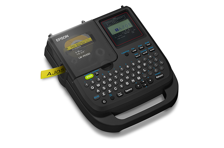

Epson
I used an Epson LABELWORKS LW-PX300ADPT, which accepts shrink-tube cartridges. I thought it did a nice job.

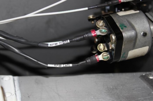

I just type out a bunch of the locations on a word processing app then print out the page. I cut the labels out with scissors then slip the label in the clear heat shrink tubing, hit it with the heat gun and you are done. I have it on my wiring that has been there twelve years and it's still like new. It's a little more trouble but cheap!
