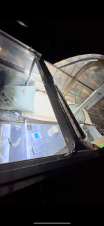

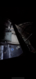

I put a strip light under the seat center brace wired to a rheostat. I can control the brightness and it’s super bright. Lights up the whole area. I have a video, I can’t post that but I grabbed screens shots for ya.
