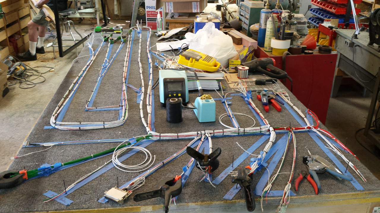

I came across this pic a few years ago and I can't cite the source. Much respect to the folks who had to install and maintain this!
RVs are not this complicated!

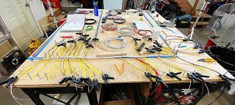

And now, for a general update, since this has sort of turned into "as the soldering iron burns" or something like that.
Originally my plan had been to get all the wires laid out on the bench, lace up whatever could be reasonable done there, and put the whole thing in the fuselage before actually doing any terminations. The more I thought about it, though, the more that seemed unnecessary. Everything aft of the spar would definitely need to wait, since the harness needs to get fed through the spar penetrations and a conduit run under the seat floors, but when it came to the busy area behind the panel...why subject myself to all that work in a tight space?
So instead I decided to first "test fit" the harness in the fuselage. I fed it down through the gear tower as it'll be routed long-term, but just passed it over the spar and conduit - those are going to be one-time tasks. All I wanted to determine was that my rough branches for the behind-the-panel stuff were of reasonable lengths, and that everything laid out roughly the way I wanted. Then I pulled the whole shebang right back out, plopped it on the table again, and got to lacing, followed by adding my first couple of actual plugs:
Basic plan now is to add all the D-sub terminations for the panel components, and probably lace up the harness all the way to where it goes through the spar. Once all that's done, then I'll get to fish this thing through the fuselage for good.

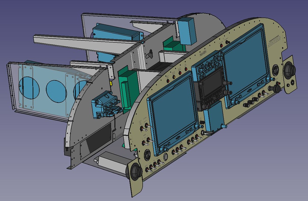

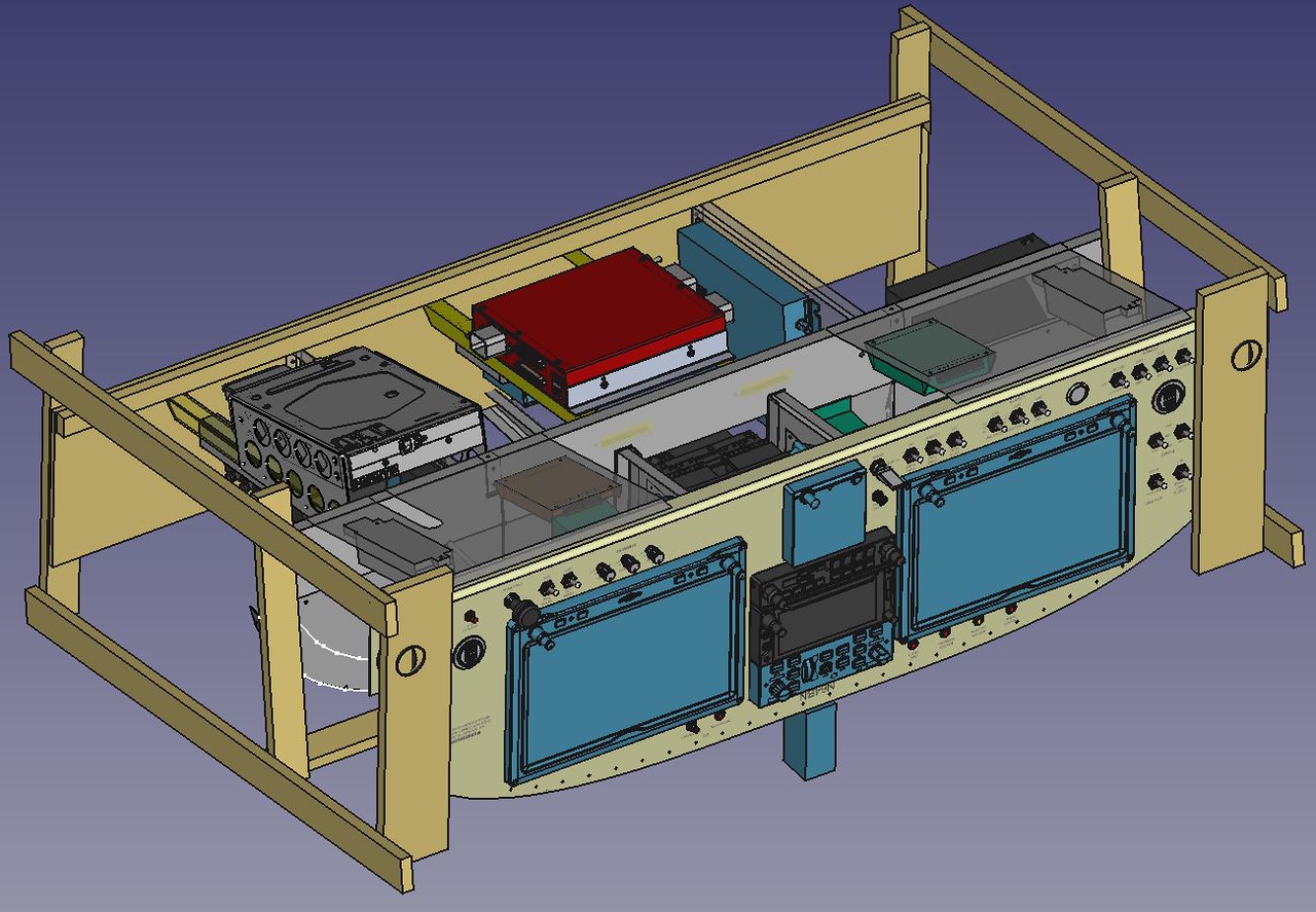

As I was travelling in the NE last year being restricted to the hotel rooms due to COVID, I did a lot of planning virtually in CAD.
I stole the the idea of putting the subpanel structure in a jig from KJBSouth, so I could work comfortable on it from below.
I laid out the cable routes in CAD and plan to have the front part of the harness removeable from below.
The cyan colored items are CAN bus nodes. I'm just about the set it out in practice....

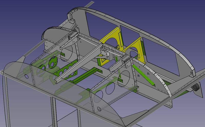

I laid out the cable routes in CAD and plan to have the front part of the harness removable from below.
One thing - the GSU 25 location is only .025" and might be buzzy. You might want to check into that. Braces etc, even a .025 angle stiffener can make a huge difference.
Also, you have removed part of the ribs from the firewall to the panel. They stiffen the sub panel. Since it is in 3 pieces, an angle all along the bottom (longeron to longeron) would greatly stiffen that panel to vertical motion, thus restoring some structure.
Trying my best not to hi-jack a harness thread and failing......
De-buzzing is a very good idea. I was wondering about making the left outboard more stiff. The bottom part is also connected to the panel via added avionics trays (in green). For now it's more about position for harness development. I need to research other builders stiffening solutions when using that location. Maybe an angle diagonally behind the GSU will do the trick unless it just concentrates the vibration into the GSU..... I get the impression that after on the GDU itself the selected location is a common solution and putting it behind the subpanel complicates future pitot-static testing.
I want to clarify that I have not removed any material from the tip-up subpanel and firewall substructure. This is how Van's designed the tip-up sub-structure. I have added some additional angles to support the Garmin LRUs (in green). One slight modification is that the non-structural rear portions of the ribs (in yellow) are moved towards the center to support the panel and radio stack. Maybe you have the slider configuration in mind?
I will do some more lightening, but it will wait until the harness support points are determined.
