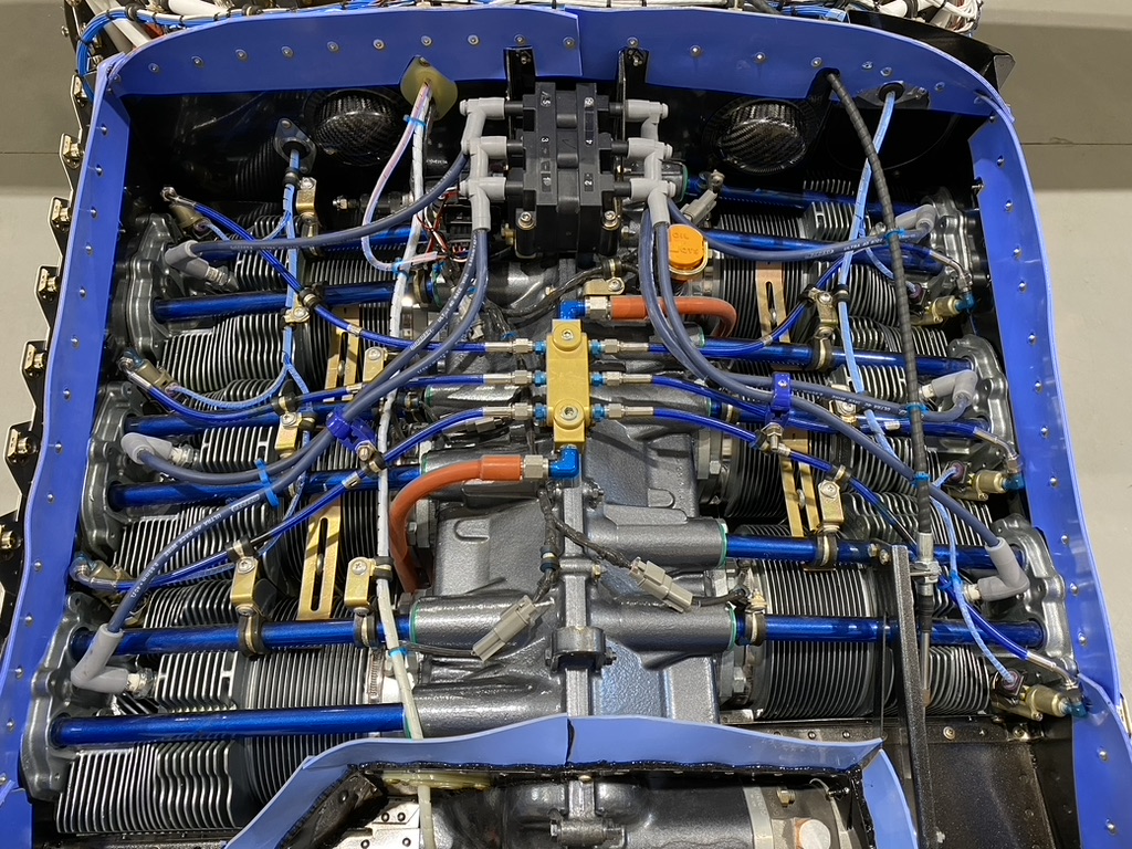

I've done one complete SDS system install on my RV-10 (IO-540) and assisted some on another on an RV-14 (IO-390).
1. Given that this installation occurs pretty late in the build process, you have (hopefully) acquired the skills you need to install either SDS or FlyEFII.
2. As Robert said, I don't think you need to do any welding. Certainly not with SDS.
3. The flywheel drilling for SDS is not that complicated. They provide a nice drilling jig that sets the hole locations. Follow the instructions, drill carefully and you will be fine. I still recommend using a timing light to verify the timing settings. Even though we used the jig, we were still off a couple of degress versus the default settings.
4. For me, the wiring was the most complicated. I was concerned both about wiring protection and appearance - so it took a little extra thought to accomplish both. We still have to do some cleanup and are working on hall effect wiring protection. SDS provides some nice mounting holes on the hall effect mount to help with that.
5. I will reach out to the RV-14 builder and see what information he can provide to you. You also have a couple of very experienced builders familiar with SDS down under. I expect they will be glad to provide you with additional insight.
6. Highly recommend Aircraft Specialty/TS Flightlines for the custom made fuel lines (and for all of the other lines too). Tom at TS went above and beyond (as always) to ensure I had high quality hoses.
7. Way off topic - but it's not too late to install Sky Designs ER tanks!
(Early picture before baffle seal re-do)
