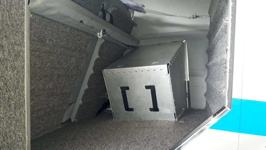

I sent an email to BRS to ask for more pictures and some more details on their installation, especially what kind of CG impact they found mounting it behind the bulkhead to see if that's something that I could do. Looking at the email they sent out now, it looks like it takes up slightly more than half of the baggage compartment, and weighs 82lbs, which basically renders the baggage compartment useless.
I want a parachute, but this is a bit too much of a tradeoff.
They replied surprisingly fast.
Here's a photo they sent of the installation. They claim it's 1/3 of the cubic footage, 1/2 of the floor space.
Went back with more questions about CG impact, weight etc.
I promised an update and never delivered.
BRS did get back to me very quick on my request.
BRS is using 83.53 lbs and 169.38" to calculate W&B for retrofit aircraft. Obviously, on new builds, you would just weigh the aircraft. BRS said via email that the structure has additional support and/or bypasses baggage area structure, so you are only limited by CG on how much weight in the baggage area.
I'll let y'all make up your own mind on whether this works for you or not.
