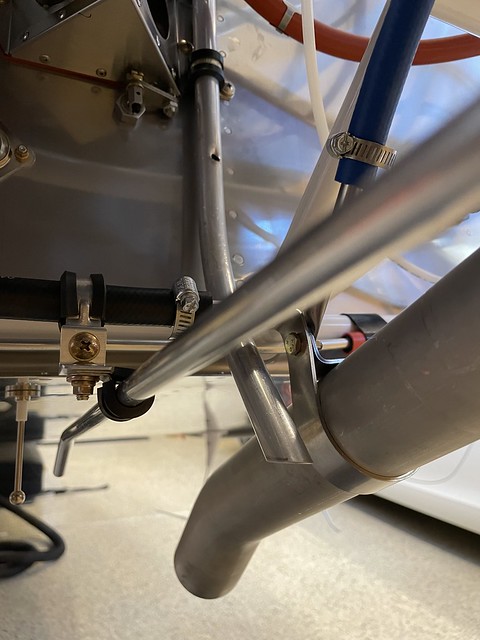

Has anyone found a hose that fits better?
See photo.
Vans provides a hose EA-CV-HOSE-9816, but it's way bigger than the breather fitting. It does fit the tube FF-705, but the flare could be removed and the tubing diameter would match the breather.
Planning on a visit to the auto parts to search.
I also didn't install the nutplate for the adel clamp. No idea how I'm going to get that done!
For whatever reason, Van's assumes your engine has a Lycoming 71140 breather installed (3/4" hose) and provides that NAPA Heater hose with 90° elbow 3/4" to adapt to the flared end of the FF-705.
The B1E, M1B, etc. seem to have AN844-10D installed (45° 5/8" Tube-NPT).
I cut about 12" from the flared end of the FF-705. Then connected a length of 5/8"ID MIL-DTL-6000D hose from the AN844-10D to the remaining section of FF-705. Attached the FF-705 to the firewall with 2 MS219190-WDG10 (IIRC) clamps.
A "second" for the parts and method Brian describes. I removed my Lycoming installed 71140, and put in a AN844-10D, after the engine was hung on the mount (so, it can be done).
One plus is that by using the 45 degree elbow, you can point the elbow (thus the breather hose routing) in the right direction towards the FF-705. And, by using the MIL-6000 oil rated hose you won't have do ever deal with the supplied auto coolant hose getting soft and sticky...as it eventually will. My original section of MIL-6000 hose lasted about 10 years before it aged enough to leak at the FF-705 connection.

I simply cut the nice bend radius off the Vans supplied aluminum tube and connected ~12" of automotive engine breather tube from Napa between the Lycoming fitting (45 degree) and a lower straight section of tube to exit the cowl onto to the exhaust. I could not find a way to connect what Vans supplied and I figured purpose made engine breather tubing was better than the supplied heater hose.... my .02.

What I did Larry and working fine:
Engine breather by Dave Hock, on Flickr
Vans says to point it towards the exhaust pipe to burn off the oil mist... I did the best I could with the Vetterman exhaust pipes and hangars.

The breather exit should point at the exhaust pipe, about 1” away. The idea is that any crankcase vapors/oil-laden mist will get burned up by the hot exhaust and not end up on the belly.
Cut a few slots in the FF-705 (whiffle slots) about 2” or so above the exit also.

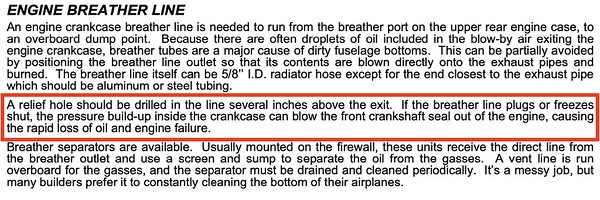

So any potential blockage (ice for example) can't block the breather and blow out the main nose seal due to excessive crankcase pressure. Mine is a "whistle" slot versus "wiffle" :)
It's in the RV construction manuals:
Manual
I went through the manual again yesterday to double check firewall forward. Never saw that. Thanks
I will re-re-read.
"Scotomisation" is the psychological tendency in people to see what they want to see and not see what they don't want to see.

Larry, suggest putting the hole a bit higher. Local A&P suggested at least 6 or so inches up (he has seen some freezing down lower)(my hole is prob 12 inches up). Simply drill a hole and use the other end of the drill bit and put it in the hole and lift up to deform the metal locally.
Also, that tube that Van's sends will very quickly get that slimy oily look. Mine already has it. Glad you started this thread that has some ideas on how to address it.
Double also, definitely get that pipe above the exhaust if you can. Anything a guy can do to minimize the mess on the underside of the plane is best.
Mine's an 8 but almost the same. I have it exiting just above the exhaust, high enough so I can "easily" get the dehydrator hose on there with just a bit of fiddling.

Freezing of the breather was a common problem in early single engine Cessna aircraft, so much so that the FAA issued an AD back in 1982. Copy below:
AIRWORTHINESS DIRECTIVES FINAL RULES: 82-07-02

To reduce the possibility of rapid loss of engine oil caused by ice obstruction of the engine crankcase breather, accomplish the following:
A) Within the next 50 hours time-in-service after the effective date of this AD:
1. Visually examine the engine crankcase breather to determine if an alternate air outlet is drilled or cut in the tube as shown in Figure 1. If any of these provisions exist, make an appropriate entry in the aircraft maintenance records per paragraph B). No further action is necessary.
2. If the hole or cutout shown in Figure 1 is not in the engine crankcase breather tube:
a. Inspect the crankcase to crankshaft seal and ensure that the seal is secure. (This seal is located behind the starter ring gear in the forward most part of the crankcase.) Reinstall or replace this seal if it is not flush with the forward face of the crankcase.
b. Drill the engine crankcase breather tube line to include an alternate air outlet as shown in Figure 1.

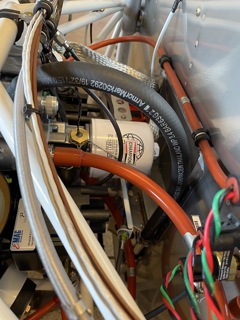

Crankcase breather
My solution worked out very nice. I think.
1. Straighten the upper bend in the aluminum vent tube. Fill it with dry sand and push down on the bench. Dump the sand and wash it out.
2. I used this hose. It's a power steering return hose so oil isn't a problem. Easy to trim and fits perfect. I ordered an extra for the parts supply.
3. Secure the tube to the firewall with Adel clamps and spacers.
Now I can remove the hose to gain access to the area if necessary without messing with the aluminum tube.
