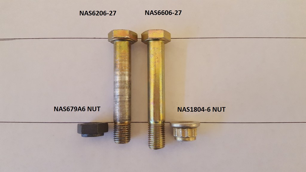

The service history of the RV-8 landing gear includes several incidents in which the nuts securing the saddles at the outboard landing gear attachments failed in tension.
