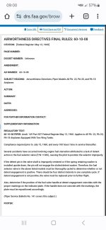

If that was my plane I would take that selector out of there and recycle that brass somewhere get rid of it. Take the one from the guy above or else I got one I can send you if you pay for shipping too get rid of that thing though
I am home now, will get my fuel selectors out and see what I have, I know I have at least a couple extra ones I dont want around anymore collecting dust, the delrin plug brass valve will outlast your plane and never needs serviced, That 11383 deadly John Denver valve you have has an annual AD on it, and needs overhauled every few years because it freezes up... what killed Denver, lost control of the plane trying to get the vice grips to turn it after engine quit. Lots of peole have died because of problems with that brass plug valve.

I've also been told that these (both types) are known for sucking air around the stem. Further that there is a SB (or AD?) for Navions that requires pulling the thing out and suction testing it at each CI. So I'm told by my A&P neighbor anyhow.
This all came up because of engine misfire at high power on my Bendix (Airflow same thing) system. Injection hates air bubbles. Bottom line if you have one of these and injection, and are getting any kind of high power random misfires this may be your culprit.
To test, disconnect at the servo, install clear tubing then an electric fuel pump to suck through the system. Bubbles not good. Wiggle the fuel valve handle, switch tanks, try off position. And no, there were no fuel leaks evident anywhere.

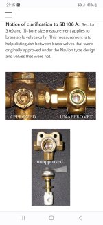

Thats a different valve, its a 4way brass plug type more like the deadly John Denver valve, you can tell those brass plug valves that kill people by the big nut on top. The delrin plug valves that work fine forever have a smaller cap. Found another pic on a different SB, the approved valve is the one thats killed lots of people but the non approved delrin plug valve is the one that works better and lasts forever....
However, the brass plug valve is what was delivered with the kit that eventually came into my hands. I was aware of the Denver accident, but blissfully (?) unaware that the valve in my plane was one of these beasts. There are a lot of 6's flying, and a lot still have the original brass plug types in them.
