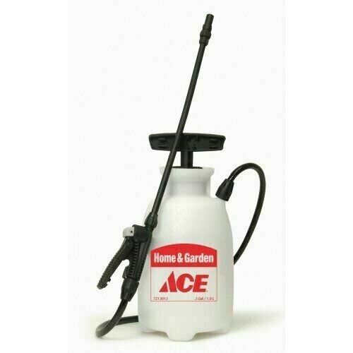

I went through a complete rebuild of my brakes in September (new hi-temp o-rings, hi-temp fluid replacement, and master cylinders rebuilt).

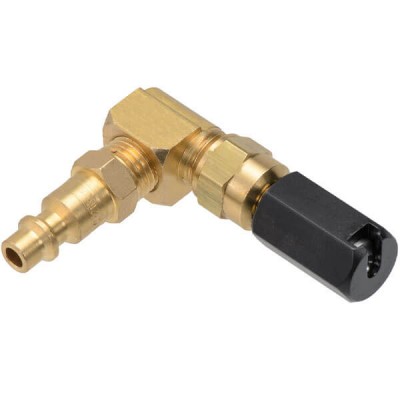

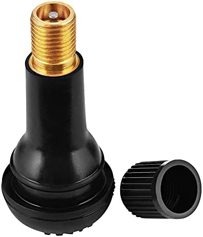

Bleeding recommendation...bottom up, pressurized, and make sure brake peddles are fully retracted. I bought a small 1/2 gal garden sprayer from Ace, and modified it with a tire valve stem to pump up with compressed air. Some have theorized that using the manual pump may cause air bubbles in tank fluid which may enter bleed line.
I have the special ACS fitting that attaches to caliper bleed valve but I don't think this is really needed, but allows you to use a higher pressure with the compressed air and bleed system pretty fast. If you don't have this fitting the hose could come off the bleed valve with high enough pressure.
