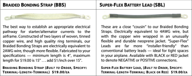

Did some reading on VAF and decided to go with braided material for engine to firewall grounding. Is there any guide to the right size of this braid? I have a standard SkyTec starter that came with the Lycoming engine, and am using 4AWG wires for the battery and starter positive current, and I have extra 4AWG crimp lugs I plan to use with the braid. I see Spruce sells a number of sizes, but not sure which one is right for this application. Also B&C offers this material, at significant extra cost. Any suggestions? I plan to double-up the braid as some builders have recommended.
I used two of these, and they say it's the equivalent of #2AWG. My starter wire is also #2 - used Eric's "super-2 CCA" cable. http://www.periheliondesign.com/fatwires.htm
I imagine that 2x #4AWG will be fine if that's what you are using for your battery, assuming that the length of the cable is not too long. Mine were about 12".

that is on the small side if you look at cross sectional area compared to the starter wire. A 1" strap would be about the minimum for starter ground return currents. Two would be better.

https://www.gacopper.com/Braid.html
gives you a equivalent AWG and a "current rating" that should help size the strap.

Bigger is better in this regard, but technically the ground strap does not need to be any bigger than the starter feed, so 4 gauge in your case. You should be able to buy pre-made ground straps in #2 of various legnths for under $10.
Don't scrimp on earth straps, can result in significant starting problems. A poor earth connection can also discharge a fresh battery pretty quickly.
