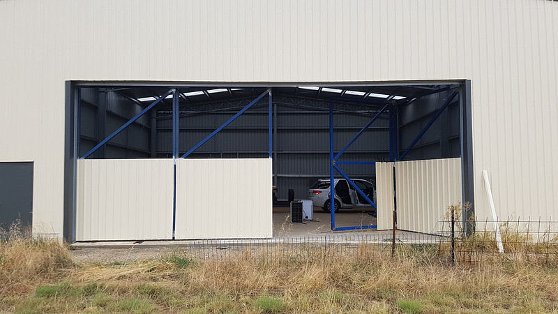

I made bi-fold doors on my hangar which is similar to yours. The first set was all steel frame but the second was aluminum reinforce with some wood where needed. Four sections for a 40’ wide opening. Would be happy to answer any questions you might have
I did very similar to what (I think) you're describing - but without the steel track.
I bolted the doors to the steel RSJ's but had a fixed HD poly wheel on the outboard door to take the majority of the weight of it and its' mate. Because that door was fixed to the hangar, the wheel didn't need to swivel, as it just described an arc based on distance from the hangar-frame-attachment points.
The inner two doors were floating above the hangar floor, supported by the outer doors and could be folded (almost) flat against them when fully open. I say "almost" as I didn't quite get the alignment of the corro sheets right such that two ridges made contact. :mad: All 4 doors were secured by 10mm steel pins at the top & bottom. Remember that even a light breeze will exert a lot of force on something the size of a hangar door! ;)
If you look closely and maybe squint, you can see the roller on the hangar door. I no longer own this hangar so can't get any better photos, sorry!
Hangar Doors
I see what you have done, but wont work for me. My hangar floor is not level, but has a slope, so I will have to have door panels that slide over each other rather than folding like you did. Thanks for the pics though.

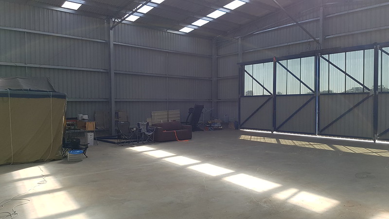

I made my sliding doors to be suspended from a track that is above and this required an engineered steel truss for the end wall of the hangar. You can save a few $$ by doing it yourself.
