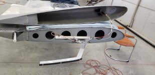

I’m putting in a bulkhead connector for my archer nav antenna and just had a quick question…
The connector creates continuity with the rib. I’m assuming this is not supposed to happen correct? I know next to nothing about comm wiring and how antennas actually work.
On the plus side, first time crimping a BNC connector I didn’t get a short between the body and center conductor so there’s that at least.

At work, anything that touches a bulkhead or intercostal, gets electrically bonded to it. Doesn't matter if it's electrical, hydraulic or ECS, it's all bonded.
Thank you.
Would it hurt to put some fiber washers I ordered to try and isolate it? Or don’t even bother?
I wouldn’t bother. Since you asked, I ran coax from my nav out to an Archer in one piece, no connectors at all. Left a little extra at the tip to allow removal. IMHO half of electrical problems (10 years down the road) are due to connections.

I’ve had a few archers over the years. By far the best performance is with a straight run from the radio to the antenna. No connectors. BNC at the radio. Direct connection at the antenna. Bolt/rivet the antenna to the outboard rib.
It’s okay if the shield touches or is connected to the airframe (ground).
When I finished my RV in 2014, the wingtip Archer antenna did not seem to work when connected through a bulkhead fitting. An electrically isolated BNC bulkhead coupler solved the issue, and the antenna has worked great ever since. It does add one more connection, which as others mentioned isn't ideal, but performance has been flawless.
That said, since Clay's is already installed, perhaps leave it as-is and test when the plane's flying? Things are very accessible at the tip rib to change later if needed.
It SHOULD be grounded. I think Bob was being polite.
A bulkhead fitting is maybe the best way to ground the shield and there is a reason for it to be.
There was a thread a while ago where an archer antenna did not work if the shield was grounded, and it was interpreted by some that leaving it all floating was best.
I can say with practical certainty that that antenna in question was bungled up and was operating in coat hanger mode.
Use a bulkhead fitting. Then the antenna will be like the rest of the antenna on the plane and be isolated from any noise on the shield which will be fed to the radio. With an ordinary antenna, the antenna is on one side of the skin and the coax is on the other. The bulkhead fitting will provide the same noise isolation to the archer. Signal sanitation.

The shield must be connected to the ‘short leg’ of the antenna, and that leg must be electrically and mechanically attached to the end rib. So the braid definitely does not ‘float’.
A connector mounted on the rib does nothing to antenna functionality (unless you screw up the BNC connectors).
But I assume you are hard mounting the antenna to the inside of the wing tip, thus the need to be able to disconnect the feed line if you want to remove the antenna. I suggest just hard mounting the antenna to the outboard wing rib and have the wingtip fit over it. No need for a connector.
I should add this is a homebrew antenna. The leg that goes out from the wing rib is longer than the Archer to take advantage of the total width of the wing tip (to enhance performance). The leg that runs fore to aft in the wingtip is nestled into the wingtip corner - it does not flop around.

Good comments, Carl. I have done a hat full of simulations of the archer and similar antennas mounted on simulated wings. Getting more "height" as you have done is a good thing.
The way the coax shield is connected to the archer usually leaves a common inductive impedance allowing any noise on the coax shield to be shared with the antenna signal. The coax comes from a high noise area. At VHF freqs noise is easily coupled and propagated by a coax shield as a big wire inside a metal structure.
So, the point is "good practice". At VHF frequencies, grounding an object with a wire a few inch long is not grounding it at all. The wire has several ohms of impedance over which a voltage can exist. So, using a bulkhead fitting is a good way to keep things clean and sanitary.

If I'm interpreting things correctly, the shield does get grounded, but I figured it did that on the antenna (one connection for the shield and the other for the center conductor) and then the mounting side of the antenna was the grounding point of the shield to the structure via rivets, screws what have you. Having a second grounding point at the fitting wont cause issues like a ground loop for VHF freqs?
I'm planning on riveting the antenna to the wingtip in conjunction with the hinge attach method. I did the bulk head connector to make it a little easier when/if the wingtip comes off.
