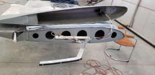

hard to tell from your photo of the tip detached, but those power lines to the lights/strobes don’t appear to be IAW archers install instructions which are explicit about routing up the forward element. Looks like they loop around over the top of the element then back outboard.
Agreed. I’d re-route those wires forward inside the rib, then bring them straight out as far forward of the antenna as possible. The instructions for running wires along the antenna are really only when it cannot be avoided.

I hand-made my pair of Archer antennae, one in each wing tip just in case I ever lost one, coax from both coming under the panel. I laid them up inside the wingtip with a little glass to hold them in place, used some copper strap for the ground connection between the antenna and the wing with the screws bonding it to the wing, and routed the light wiring per the instructions. Works perfectly.
I will review this and improve. However, the situation has been unchanged from day 1 and did not seem to cause any issues.
The only recent change (after starting to trouble shoot the GS issue) is the addition of the black grounding strap that improves the ground connection to the wing. Previously that was only established through the nutplates and screws to wing skin contact.

- I first wanted to try to improve the grounding, knowing this was somewhat sketchy from the start. The antenna ground leg, metal strip that holds the nutplates and nutplates themselves are all on the inside of the fiberglass wingtip and the connection ot the airframe was mainly established via the screws/nutplates (and the screws over the painted skins, i think i intentionally removed the paint on one of the screw holes!). Yet it worked for all these years, however it could have corroded.
- So decided to add a dedicated grounding strap, connecting the ground side of the wingtip antenna with the outboard wing rib. This did improve the strength of the Nav Audio return (at least I believe it is more than expectation bias *G*).

On four RVs I built a standard wingtip antenna out of aluminum from the scrap box, some fiberglass to make the Gama Match, and perhaps $3 of specialty hardware. It works outside 100nmi for VOR reception, and LOC/GS far beyond useable range.
So what is good enough? As has been posted there is an impedance mismatch on GS frequencies. In practical application however the antenna GS reception is still more than adequate (assuming something else is not wrong).
Some other thoughts I’ve posted in the past:
- The Archer instructions tells you to run the nav/strobe/LL wires along the antenna leg extenteinding into the wingtip. I consider this simply asking for RFI injection into the NAV receive and perhaps the other radios. Move the antenna a foot or so aft and eliminate this issue. While most LED nav/strobe/LL are now much quieter at VHF frequencies they can still be an RFI source.
- Ground straps and such seem to cause more concerns for builders than not. Eliminate the issue by mounting the antenna on the outboard wing rib. The wingtip then just fits over the antenna.
- The Archer antenna does not take advantage of the total width of the typical RV wingtip. The antenna leg going from the wing rib into the wingtip can be extended, and the leg running fore to aft in the wingtip shortened by the same amount. This will enhance performance. Keep in mind for a quarter wave antenna the majority of the work is done by the first third of the antenna (the high current portion). An antenna analyzer is needed to do the final resonance tune and system check of our antennas (store bought or not). I consider this a must have shared tool for all EAA chapters.

I recreated adding the horizontally polarized glidslope band to the Archer antenna.
The width of the strip is 6 mm, the length measured from the centerline of the Archer pickup strip to the end is 17.1 cm. It is placed in the center between the two nylon bolts.
