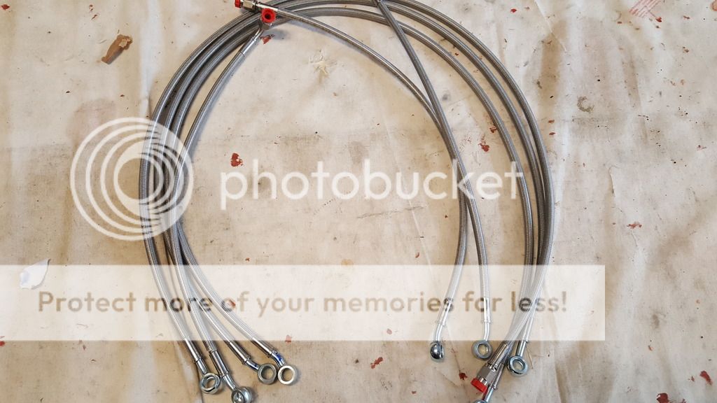

• Stainless steel braided brake hose comes standard in the Beringer kits

• The lower fittings on the master cylinders use banjo fittings with a 20 deg sideways bend to provide better routing of the brake hoses (see picture below).
