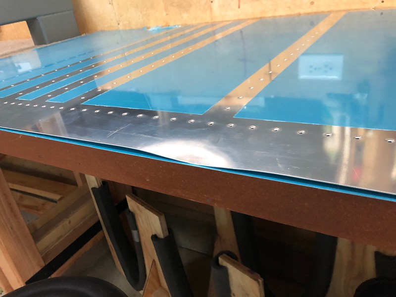

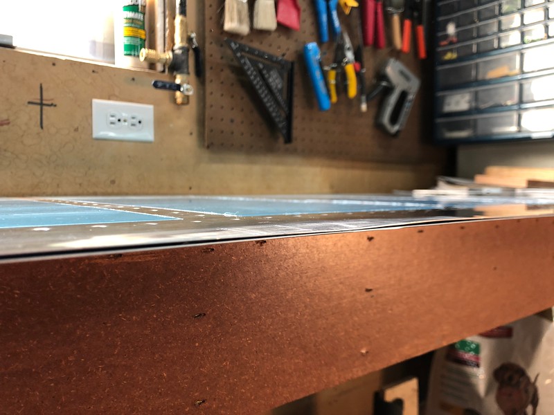

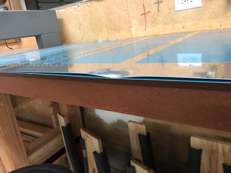

Some days it seems like it's disaster after disaster on the RV-7 project. Today's one of those discouraging days. After a mishap with the deburring wheel, I'm left with a pretty badly bent wing skin:
This is the trailing edge of my top right inboard W-702 skin, after a great deal of re-straightening on my part. Maximum deflection in the center of the bend is approx. 1/4 inch. Looking ahead in the plans, it looks like this section overlaps the flap, and there are no rivets going in here that could "aid" in its straightening. The fit against the flap looks pretty tight, so this would probably end up rubbing against that control surface. I'm afraid it looks like I'll need to be ordering a new skin, but before I do, I thought I'd ask if anyone has any good repair ideas.

Since there is no choice except straightening or buying a new skin, I would go at it like there was nothing to loose.
I would put a piece of plywood under the area with a layer or two of soft cloth like a towel in between. Using a small round head bump hammer (body work hammer from HF would be about right) and gently tap back onto shape. The ply and cloth will have enough give when tapping to pull the surface in. Use a straight edge to repeatedly gage when the surface is flat. If it still has a little bit of roughness when finished, a little filler before paint will clean it up.

If I am looking at it correctly, the bent end is what goes over the flaps. Since there is no support for the edge like up against the fuel tanks, it will be difficult to repair. You might as well give it a try. Once you get it bent back up and flattened out, you may have to find someone with an air powered stretcher-shrinker to get it straight. They can work wonders.

The metal has been stretched. It needs to be shrunk and there is no reliable way to shrink an edge of thin 2024t3 that I know of. The lancaster shrinkers leave marks that will likely result in cracking. If it was in O condition you could shrink it but t3 is way more difficult.

Use a piece of wood on top and on the bottom and C- clamps to straighten the area. You will have some spring back and the inevitable stretching, but it should be minimal

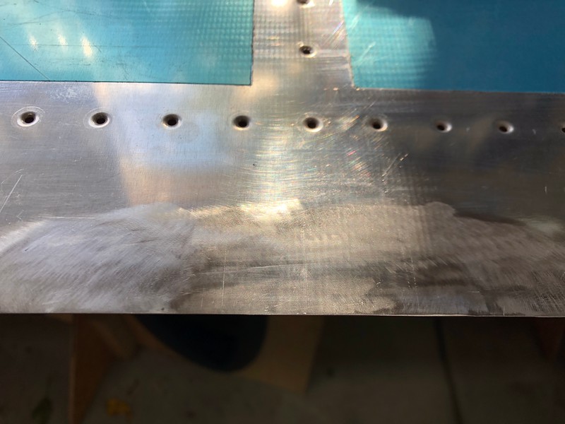

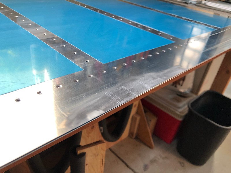

In case anyone's curious, I put a little elbow grease and a metal shrinker into the skin and had the below results (bent skin on top, straight one below for comparison):
Much better, but at the end of the day, I will be re-ordering the skin anyway. I'm not happy with the score marks that the shrinker tool leaves, which as Scott pointed out may lead to cracks eventually.

Just for kicks, try polishing out all of the score marks with Scochbrite and measure the resulting metal thickness.

I agree, I would try polishing out those marks before committing to a new skin. Your repair looks quite good, it will ride on top of the anti-scuff tape of the flap.

There is minimal localized loading of the skin at that point so the likelihood of future cracking is quite remote (just make sure the very edge of the skin is polished well). In fact it might be more likely if you thin the material excessively.
In my opinion a better fix would be to sand flat (just enough to assure there is nothing raised above the normal skin surface with 220 and then use a small amount of filler applied with a razor blade to fill what amount of groves is left. Sand the filler flush. Once a bit of filler primer is applied and block sanded it would probably be undetectable.

After some scuffing and polishing, with most of the score marks gone, I'm down to 0.0275" at the thinnest part of the sheet.

Interesting, since if you take away the 11% thickness (5.5% per side) of the low strength pure aluminum Alclad layer you are left with 0.0285" of the higher strength aluminum. :)

About the same amount on each side because the scoring was as bad on both sides. It's not super smooth. The thickness of most of the repair is about 0.030+ but there are a few thinner areas.
