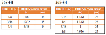

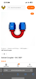

I've spent 3 hours unsuccessfully trying to figure out how to make the fist few bends in the fuselage fuel vent line, when it comes off the bulkhead fitting through the side of the fuselage. The first bend needs to be nearly 90 degrees and needs to happen in less than an inch, to clear the angle directly above the fitting. I seemingly have every tubing bender known to man, but none can make such a tight radius. And after that first bend, it needs to make a nearly 180 bend, to go around the angle and back to the fuselage skin. Again, no tool I have or have seen, can make such small radius turns, and it has not been possible to do it by hand (not enough leverage without kinking the tubing).
And secondly, that first straight run from the bulkhead fitting needs to be VERY short. The AN819-4D sleeve needs to go on before flaring. So that means the flaring tool is holding onto the SLEEVE and not the tubing, so the tubing just slides through the sleeve as the flaring took tries to flare the tubing. Any neat solutions for that?
I just cannon see or find any way to have the sleeve in place, on an absurdly short straight run, and make a 90 degree bend all at the same time. And then make a 180 degree turn.
