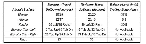

Also following this. I have a cosmetic issue on the right elevator lower trailing edge skin near the closeout tab. Vans support said I could use filler to fix the problem before paint as long as it didn't exceed the values in the attached table.
How do you accurately measure trailing edge heavy in in-lbs? Should RV-10 elevators be slightly tail heavy, neutral, or nose heavy, and if so by how much?
An easy way to assess the in-lbs of the elevator trailing edge is to put a digital scale under a point along the trailing edge to hold the elevator neutral. Note the weight in lbs. Measure the perpendicular distance between the weighing point and the hinge line, in inches. Multiply the weight (lbs) by the measured inches, this gives you the in-lbs value.
Sorry I don't know the answer to the second question but would assume it should be neutral or slightly tail heavy (within the tabled limits), but not nose heavy.
Is the attached table for the Rv-10 only? Is anyone aware of published specs for the -14?
Vans pointed me to the PDF called "RV-10 Manual - Main.pdf." The table was on page 2. Maybe something similar exists for the -14.
