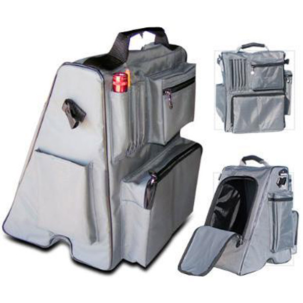

The best thing I have ever found is the Mission Bags. I'm not sure if they are made anymore unfortunately. I had them for my first RV7 and got some for my newer RV7. They are designed and sit behind the seats. They are slanted to match the seat back angle, maximizing space. I set up the pilot side bag for stuff I need for day to day flying. Tie down rings, window cleaner, oil and spout, tie downs, control locks, fuel sump, air pressure gauge etc..... The right side bag has maintenance items. Tool kit, spare tube, parts container with fasteners. You get the idea. Really nothing else is needed. I like neatness and organization and the Mission Bags provide this. Hopefully you can find them.

Bison bags, available from Aircraft Spruce and maybe others. Fit my RV6 perfect, very useful, a good start to getting a cockpit organized.

I just bought the Bison Mountain bag and love it. Was looking for a way to keep all my spares, tools, covers, etc neatly organized and secured, and have gone through several attempts before this one. It is cavernous, and because of where it sits, leaves your baggage area essentially untouched.

Yeah, these are the ones. I think long ago they were called Mission bags but I'm probably wrong. They will hold everything you need for an extended trip.

Lots of good ideas to work on, thanks! I’ve already bought two of the wedge shaped Bison bags from Spruce. (I’ve used one in the -8 aft baggage and it works well there.). Thinking I want them for “luggage” only. Wife seems happy using one, and I think they’re pretty handy. Already using one fuselage side above the flap linkage for the fire extinguisher. Thinking I’ll fabricate a dedicated bin on one side with a lid and screwed to rivnuts in the floor or side leaving enough room for two Bison bags behind the seats. Need it movable for folding bikes! Next step.

You’re correct, Mission manufactures the bag. ACS carries them under the name of Bison.
Here’s a link to the Mission website.
Edit: I noticed that Mission carries a flight bag called a bison but it’s not designed to fit behind a RV seat. The bag we want is called a RV flight bag. Maybe ACS just got the name wrong??

Whatever they’re called, I got two. They’re a very good product.
I think they were always actually called "RV Flight Bags", but the manufacturer was called Bison Mountain Bags so the name just stuck. Then the company was sold to Mission Bags but the unofficial name lives on.
