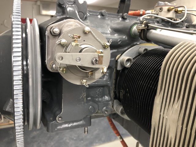

In test-fitting my Van's prop gov cable, with the blue knob all the way in, the cable is still too long to line up with the governor (PCU 5000) control arm in its low pitch extreme of travel, even with threads backed all the way out like yours shown. Looks like I'll have to trim down and possibly cut more threads on that cable shaft or else live with "balls to the wall" not really being to-the-wall for the blue knob. That seems not desirable.
Anyone else run into this? Did you shorten the cable end length or shim the bracket maybe 1/4" away from the underside of the #2 baffle? I'm not gung-ho about either option. What am I overlooking?
ETA: after thinking this over a bit more and studying my own pictures while at work, I realize the arm on the PCU5000 could be re-clocked on the shaft to better align with the cable throw - as long as care is taken not to get near the limits of an over-center situation. Is that correct? May be all the adjustment I need, if so.

Looking last night at the PCU5000X control arm, there's no way to re-clock it on the shaft without disturbing the factory set high and low RPM/pitch limits, which I am not going to do. Wouldn't gain me enough extra travel to accommodate the cable limits anyway.
I've threaded and shortened the shaft on the end of the Prop cable another 1/4" which is another hard physical limit where the threads align with the outer sleeve when fully retracted (knob pulled to coarse pitch). I will add 1/8" shims under the cable bracket feet. Hopefully these two changes will pull the cable back far enough to align its travel with that of the control arm. Not really rocket surgery, only an extra couple of evenings on the build, but I'm surprised the factory cable and bracket are made so close to the extreme end of the stack-up tolerance for cable travel.
I think there is Bill... i had to reclock mine. I had to cut away their awesome safety wiring and the whole thing spins. I have not adjusted the upper and lower limit, i'm hoping that it wont need to change.
Here's my present PCU5000X setup:
You're saying if I remove these screws and reposition the outer portion 30 degrees clockwise, that the internals will work normally provided I don't disturb anything else? Because 30 degrees will solve all my cable throw issues quite nicely.

Correct - if you remove the safety wire and loosen all those screws, the whole thing rotates. When I ordered mine, I guessed at the angle. I was way off, which kind of sucks, but it was simple to adjust. Mine came with instructions on how to do it.
Thank you, Charlie.
I'm sure they sent that document with mine. I should've dug it out and read it. I wonder about me, sometimes.
I gather that the six screws stay in their same holes and the arm position is infinitely adjustable by rotation, retained by friction. That's great - just what I need.
All I need now is some fine safety wire...
