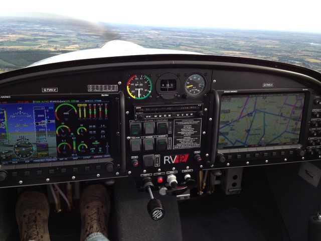

Looking for another modification to do. Considering a panel mount compass like this one
http://www.aircraftspruce.com/catalog/inpages/airpath_compass1.php
Would interference be an issue if mounted in the panel with all the other electronic gizmos ?
Looking to do airspeed and altimeter too. Eventually.
I put that very compass into my panel, it is the only device in my panel that is not a computer networked whiz bang electronic gizmo. Figured it would be good to have one stone age instrument, if only for sentimental reasons. I mounted it top left corner, next to one of the three G3X screen, and it is surprisingly accurate, once I swung it. Try to keep it away from wiring, and it should work OK.
if the electronics already in the panel would interfere with a compass....
They do, and that is why the compass will have adjustment screws to get it as close as possible and a compensation chart to account for anything that can't be handled with the adjustments. There's nothing all that exotic behind the panel of a -12 as compared to any other GA plane, so I would think the adjustment range would work as well as with any other "legacy" plane.
I have a similar compass mounted in my panel. Had to fiddle with it to find a good position, but was able to correct it to within 2 degrees. Transmitting deflects it temporarily.
The worst effect is from the joystick in my case. Mounting low on the panel wasn't an option.
Each panel is going to be different, but it is easy to power up and move it around for the best spot. Electrics on/off only makes 3 degrees difference on mine.
Thanks for all the real world experience answers..... It seems it can be done with minimal hassle!
I have that same Airpath compass and it was accurate enough to discern the magnetometer in my G3X was incorrectly calibrated. Now fixed.
I also have a UMA ASI and a Winter Altimeter, all three 2-1/4", that fit above the Garmin radio stack and I'm glad to have non-electronic backups.
We have a compass mounted above an SL30 and between two SVs.
Works fine with no issues. We swung it using the SV, makes life simple!
