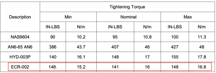

Maybe I missing something, from the Beringer manual:
Torque axle nut to contact by hands, do not force. (WARNING)
The Beringer does use roller bearings, but I don't recall them having a center spacer to avoid side loading them like the nose wheel does.That's what I was thinking. Don't know what is inside a berringer wheel, but I would NEVER tighten an axle nut with tapered roller bearings with anything but my fingers. Even a sealed bearing wouldn't be torqued in most circumstances.
Larry
My Beringer instructions indicate 220 lb-in for the axle nut.
I guess they changed the assy for the 14?
I would double check with Beringer on that torque just to be sure.
