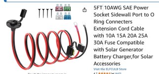

How about this one.
Good luck
How about this one.
Good luck
How about this one.
Good luck
Looks great. Found it at Amazon for $10. Your link shows $199 and out of stock.
Johan,
If you just need something for charging and not worried about jump starts then make it easy and install one of these. I had one in my RV-4 and now in my RV-8 and they work great. I mounted mine inside the aft cockpit for easy access but my hangar neighbor next door drilled some holes in the aft fuselage near his battery and mounted the plug in on the outside.
