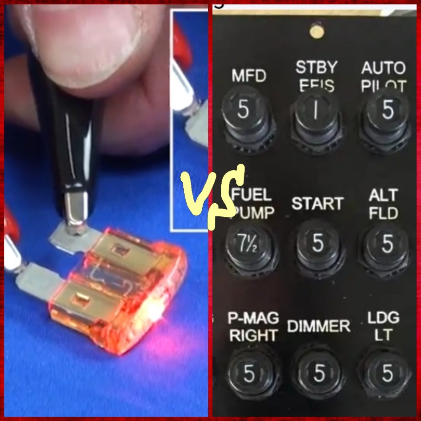

Hello Guys,
We see all the time black circles
type of fuses that jumps out
once done. Why we don't see
more LED warning fuses?
As we see in automotive.
Is it any aircraft related uniqueness ⁉️
Thanks a lot
Roman

Beware. I used to use LED lit fuses as they seemed like a good idea. A couple of years ago I delivered a newly-built experimental Backcountry Super Cub to the owner flying from FL to New Mexico. The aicraft had an automotive fuse panel on the kick panel filled with blade fuses that lit up on failure. The onboard USB charge port seemed to work fine for.about two hours and then stopped charging. When a portable device was plugged into the port it would recognize the power and show it was charging. But it would not charge and would actually discharge. Ultimately the culprit was a failed fuse. The small current used to feed the failure light was enough to keep the USB port lit up and cell phones and iPads tricked into thinking they were charging but not enough to have it act properly. Now when something still powers up, there doesn't seem an immediate need to check the fuse. After hours of trouble shooting replacing the fuse was the answer. Adding to the frustration the failure light was too dim to make out in daylight and a crude continuity check showed things good.
Once I stopped to think about it I realized that upon failure there has to be enough current to light up the failure light. Not a problem for most legacy circuits but definitely a problem for modern low-power digital devices. And the continuity checker could pass the LED (probably in only one polarity so I guess I hit the 50/50 chance).
I switched thenwhole.bus to non-indicator blade fuses and the failure gremlins went away.
So fuses are great. But beware the "illuminating upon failure" type. ��

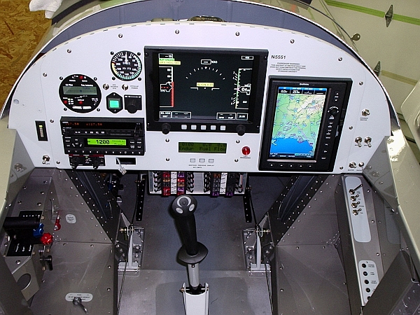

I do see a need for fuse holders designed for clean, visible, accessible in-panel mounting. Anybody know of good ones out there?-Otis
Very interesting thread- especially hints that my own input early on may represent old-school, out of date thinking!

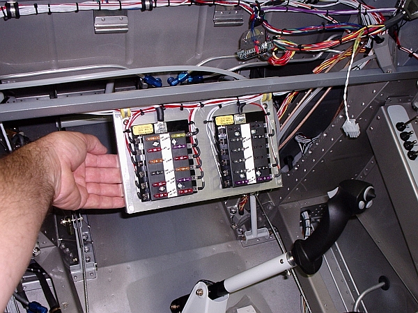

Just as a historical point of order, fuses came before circuit breakers in the evolution of all things electrical.......
You can save a lot of weight and panel space compared to breakers. The fuse block can be mounted as a drop-down:
errr, well, theres panel space, and then theres "not otherwise gonna be used" space.....weight, yeah I lose on that one however.....
Drop down
The Buss brand fuse blocks are probably the most popular. Example:
https://www.steinair.com/product/12-circuit-fuse-block/

This drop down fuse block seems like a good idea for gaining access when needed and being out-of-sight the rest of the time.
Are there any potential problems due to the fuses being inserted from below, i.e. gravity is going to be working against the friction that is holding the fuses upside down in the block?
I wonder what sort of latch holds the tray locked when the fuse block is swung up under the panel.
The first time you try to get one of those rascals out, you'll lose all concern about them falling out. They are held in very firmly. I put a drop of ACF50 on mine before I put them in just for a bit of corrosion protection, and they are still hard to remove.
I'm at 20+ years with just such a set-up in my RV-6. The fuses have always stayed in place. Not definitive just one data point. I used 2 wing-stud camlocks to hold the non-hinged side up. Doing it over, I might consider just using Velcro instead of the camlocks.
Friction and velcro

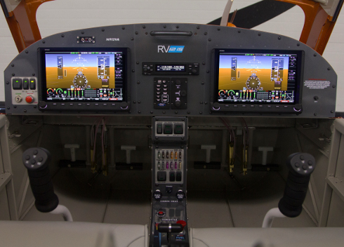

The RV-12iS uses fuses - see the center console. So Van's is comfortable with them in at least some locations for some purposes. The RV-12iS does not have breakers, as far as I know.
