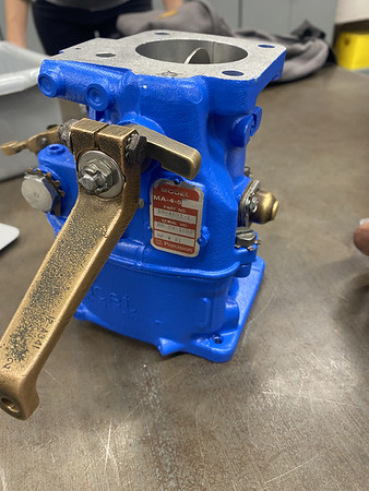

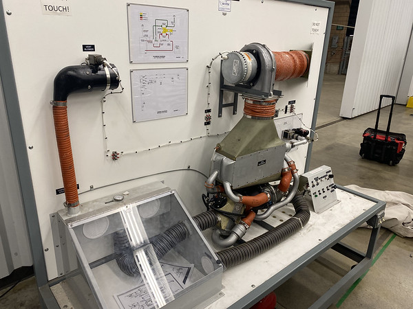

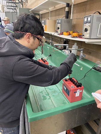

I did the A&P School route recently. I learned so much more about airplanes and maintenance than I did from building my RV-9A. As others have pointed out, it is a license to learn.
In my cohort of classmates, I was the only pilot and builder. That gave me some advantages. Some of the students were straight out of High School, and others were just out of the military. A wide variety of skill levels and experiences for sure. I was able to scoot right along through all of the lab projects, whereas some students could hardly use a screw driver.
I have written lots of blog entries about my experience going back to school, so if you want more detail read on here:
