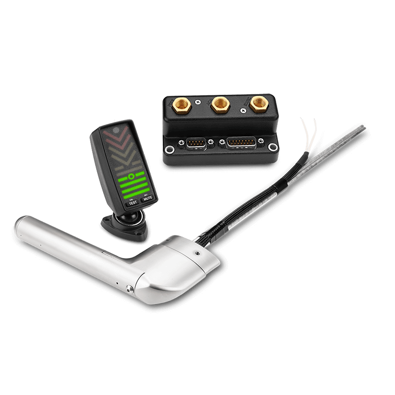

In your case a Garmin GAP-26 heated AOA system may offer you an easier acceptable solution. Even though Aircraft Spruce says that this cannot be used as a stand alone system this is incorrect according to Garmin. I contacted them directly and they stated that it can be installed and used as a separate AOA system with the GI-260 externally mounted display. According to my e-mails with Garmin, the calibration does not have to be done on the G3X, it can be done directly on the GI-260 display using the Test button. G3Expert can chime in here but all the online data indicates that you have to have the G3X but evidently that is not true.
I was going to buy this system because I would have liked having the external display mounted on the glare shield instead of buried in the EFIS. I don’t look at the EFIS in the flare anyway, I just listen for the tones. Having your AOA display up high in your field of vision would be a plus I think.
Aircraft Spruce has the heated version and you can get it from Garmin as well.
At $1945 it isn’t cheap for the heated version but this is all you need and should be a fairly easy install. Take a look at the manual located here:

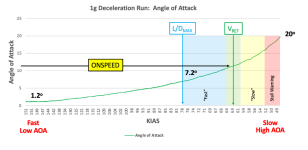

I have the OnSpeed system installed. It has both audio and visual indication of AoA. The is a lot of information available on VAF about the system. In addition to the flight safety benefits, this system should help me optimize STOL operations.

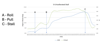

Forgive me for copy paste from elsewhere though it hits my point RE pressure differential vs true AOA. Note I’ll say Lift Reserve but really this more broadly applies to all pressure differential systems. First, a reference to Jim Covington of the Titan Group via Stoney Lake https://www.stoneylake.org/pipcom/AOAr.htm for several quotes:
“This instrument measures the difference in dynamic pressure at two ports. The pressure at each port is proportional to two things - the dynamic pressure due to airspeed, as would be measured by a perfect pitot tube, and the cosine of the angle of the axis of port opening relative to the angle of the oncoming air - the angle of attack of that particular port. As the angle of attack of the instrument changes, the difference between the dynamic pressures at the two ports also changes. As you increase the angle of attack, the angle of attack of the top port increases and the bottom one decreases, so the pressure at the top one decreases and the bottom one increases, so our instrument shows a change in the difference between the two. So far, so good - it's pretty close to an angle of attack instrument.
“Here's where the problem is - changing the angle of attack is not the only way to change the difference in pressure between the two ports. You can also change this by changing the airspeed without changing the angle of attack. Imagine the top port is directly into the wind, and the bottom port is angled downward about 45 degrees. The pressure at the top port will be 100% of the dynamic pressure, and the pressure at the bottom port will be about 70% of the dynamic pressure. Our instrument shows us some reading (I don't know what reading - it depends on how it's calibrated.)
“Now imagine you double the airspeed in the wind tunnel. The dynamic pressure with go up by a factor of 4. Here's the important point: *The difference in pressure between the two points will also go up by a factor of 4. * So the differential pressure gauge changes! This is why one of the major manufacturers of a similar system calls it a ‘Lift Reserve Indicator.’ It shows the ‘lift’ your wing is producing, not the angle of attack. Now if you're not turning hard tight turns, this really doesn't matter all that much. You do want to know how much lift you're making, especially during landing and when trying to maintain Vx, Vy or best glide.
Hence why your gauge doesn’t quite display critical angle for stall and reads a touch lower in the accelerated stall. This is, however, far better than ASI’s accelerated stall deviations in reading from stall, and in the case of a pressure differential gauge, it can be eliminated with ports spaced by an angle equal to twice your critical angle. As manufacturers don’t know your specific critical angle, they’ll build close enough with partial reduction in error. Which brings me to my copy paste thoughts from an old email thread:
(I would challenge Vx and Vy as they’re not strictly based on the aero, they’ve got to account for propulsion too; you can approximate them only slightly better with AOA as you can speed. AOAx and AOAy resolve weight but both sets Vx, Vy, AOAx, and AOAy fail to account for density altitude to include but not limited to if/when compressibility becomes factor. But this gets complicated really quickly and is a topic for another time. If you want to ponder it, start by considering how you find absolute ceiling (you can neglect compressibility for this pondering). Now consider the implications of this in terms of what is constant and what varies. A jet has constant AOAx till compressibility comes a factor while AOAy sweeps up with altitude to meet AOAx at max ceiling. A theoretical prop would have constant AOAy with AOAx sweeping down with altitude till both met at ceiling and this AOAy would happen at min power required, but due to propeller inefficiencies, AOAy starts much lower than min power and sweeps up while AOAx starts a bit higher than min power sweeping down with altitude (see Aerodynamics for Naval Aviators).)
So, if we’re at 100 and we assume 100 produces a sufficiently low AOA so as to be negligible to front port angle, the bottom (slant) port reads a 70 giving us a ratio of 1.43 but a differential of 30 while if we were at 400 at the same angle of attack, the slant port would see 280 with the same ratio 1.43 but a differential of 120. This is why the accelerated stall shifted on the Lift Reserve as it only approximates an AOA. A true AOA vane shows no shift.
In our case, we stalled power off straight ahead at around 60 mph and “AOA” at the edge of the red and white. In the accelerated, we started at 150-ish, rolled, and pulled, and saw the stall in the middle of the white. We had some other differences in there as power off / power on makes a difference. Believe I had my placard marked as Full Flap and Half Flap versus No Flap on gauge stall locations, but turns out this has much less effect on the gauge than does power on versus power off in my airplane such that I’ve made a new placard marking power off versus power on and discounting flap position. Power on unaccelerated is halfway into the red or 1.5 ticks into the red. Hence, as we likely stayed power on in the accelerated stall, we saw roughly a three tick shift of our stall on our “AOA” unaccelerated to highly accelerated.

Let’s take this one on.
Let’s just start by saying you shouldn’t be doing 5g in a Split S as you shouldn’t have adequate speed to pull 5g as you should slow before starting the Split S. Fighters have an exception here as they may start sufficiently fast though if they do so, it is because they either want energy to go up after the Split S or have energy to fight a rate war after the Split S (two different ideas, two different game plans, not two ways of explaining an idea). If in a radius fight (a third game plan), they too would want to be slow going into a Split S.
Our roll into a steep AOB and pull, however, was close to this 5g stall scenario.

While the critical angle of attack is constant, and this speed ratio for 1 g unaccelerated stall to 5 g accelerated stall is constant at 2.2, the speeds themselves change significantly, but what of the pressures at the ports? They change too but at a much dampened value.
For ease of comparison, rather than converting to pressures, I’ll look at speed of air at each port in each condition.
My probe has a front port at zero degrees and a bottom probe at 45 degrees down. Stalls typically occur for most airplanes at fifteen to twenty degrees AOA.
If we presume a critical angle of fifteen degrees, the front port will be fifteen degrees above relative wind while the bottom port will be thirty degrees below. We’ll assume an unaccelerated stall speed of 65 mph which would be for an overweight RV. We’re going a little fast as the faster the worse the skewed effects.
Front probe 65 cos (15) = 63
Bottom probe 65 cos (30) = 56
For a difference of seven
At 5g, we have 65 √5 = 145
FP 145 cos (15) = 140
BP 145 cos (30) = 126
For a difference of fourteen
And the difference of differences is seven. So the speed difference is eighty while the differences in the probe port comparisons is only seven. Much closer to zero or holding constant. But not perfect as a vane would be. Yet significantly more functional than speed in terms of stall avoidance. Seems you actually can use the Lift Reserve at 5g though if you’re going to do so regularly, you may want to make a 5g reference mark. If not regularly doing so, avoid the caution range using it as margin. (The FIKI Cirrus is ok; it is a vane not a lift reserve. Icon A5? Probably not pulling 5g.) (Do look up the Icon POH and see how often and in what ways they use AOA in normal and emergency procedures!)

Lift Reserve not perfect but not bad. Stay in the green for high g maneuvering and we’re ok.
The slower your unaccelerated stall speed is the less these differences will be and the closer your critical angle stall angle of attack is to half the angular difference between the front port and bottom port the less these differences will be.

Paul, forgive the delayed response—late to the fight, no excuse. For our ONSPEED.org system, we are still working ESP-32 integration, so nothing to report currently as we write the code to go with the new hardware.
As for the AOA system recommendations, which was the original intent of the thread, let's consider a few things:
Short answer:
Start with the one you have if you have an EFIS from any of the major manufacturers that build experimental avionics. All of them include some form of indigenous AOA capability, usually based on differential pressure or IMU-derived AOA. It may be necessary to install the appropriate wing mounted sensor and add an additional tube added to the wing if the original builder did not install a combination pitot/AOA. Some systems will utilize an additional pop rivet, a dedicated AOA sensor, ports in the wing skin or a stagnation sensor on the leading edge of the wing. Some systems use a wing mounted vane. If you don’t have glass, an LRI as described by Fffflats is a good inexpensive alternative, but several other very good stand-alone systems are available (e.g., Alpha Systems and SafeFlight). Ultimately, any AOA (when properly calibrated) is better than no AOA. Read the manual and calibrate your system in accordance with the manufacturer’s instructions. Flight test the system until you gain confidence in its performance. Trust but verify—before you turn base using AOA as a reference, cross check the AOA indication or tone against a known airspeed to confirm proper operation, and then "fly the wing." Flying a precise AOA cue is one of the easiest ways to increase precision and consistency in your landings. A common observation of folks new to AOA is “I’ve been flying too fast” on approach.
Long Answer:
Accuracy and limitations vary by manufacturer as does the technique to measure AOA, but all systems will provide progressive stall warning when properly calibrated. This feature is what makes AOA superior to conventional stall warning by eliminating the startle effect associated with unintentional stall. The “at least five knots” required for conventional “stall horns” (usually designed to meet FAR 23 performance requirements) only works out to a few of degrees actual AOA warning, and as Fffflats points out, AOA increase is non-linear as you slow down. If the stall warning goes off and you are dutifully maintaining Vref, you are within about 1.5-2.0 degrees of actual stall—not much margin for a handling error or gust upset. That math is explained here for those interested in drilling down into the aerodynamics.
For the non-engineering crowd, remember “the slower you go, the faster you go slower.” This is shown in this figure which shows us how hard the wing is working relative to airspeed. Note that airspeed is decreasing as you read the chart from left to right:
You can see from the plot of AOA vs airspeed, that the wing is doing 75% of its work in the lower half of the speed band of the airplane. At Vref, it is using 60% of its capacity to generate lift, and the requirement for lift increases rapidly as you get slower. This is why it it’s relatively easy for an accelerated stall after takeoff or before landing to catch a pilot off guard.
There is no requirement to have any sort of stall warning or AOA installed in our experimental RV’s. As Paul has eloquently pointed out, it’s a myth that we can fly any airplane by the “seat of our pants.” And we know experience isn’t always a good teacher as just as many experienced pilots die due to loss of control as inexperienced ones. This demonstration shows the small amount of g and adverse yaw (improperly coordinated rudder) that will cause a loss of control in landing configuration in an RV-4 without any buffet cues. Note, however, that the AOA is screaming at the pilot as the airplane approaches stall:
In the demonstration video, a series of tones are used to convey AOA information to the pilot that were first used by the military in the 1970’s. They are based on a simple trend as AOA increases from L/Dmax to stall and sound like this:
If we superimpose the tone pattern over the figure above, it looks like this:
This is what we mean when we assert that AOA has the capability to provide outstanding progressive stall warning. In this case, we simply capture some other key performance parameters as well. We’ll explain this in more depth when we discuss aural cues, but first let’s review some basics in the next post.

Transient Response
This is an engineering expression that means “how well does everything work when the pilot maneuvers agressively or the airplane encounters turbulence.” AOA is an inherently noisy signal—you can see this with some systems if it’s a bumpy ride down final. It’s practical to damp the AOA signal with the right signal processing and ergonomics, but not all systems do this equally well. Under the same conditions, the airspeed will also be “active” and to provide additional margin, we increase VREF that imparts extra energy we still must dissipate to land. With the right physics and “display” logic (which may be a tone), we can generate a flyable signal that is accurate in a gust of wind or when the pilot makes a rapid flight control input and always detects stall before critical AOA is reached. With adequate transient response, an AOA system will work in gusty conditions and under high g.
That last bit is important, if you pull on the stick (or yoke), you induce g and AOA increases. The same thing happens when you hit a gust load. Here’s an example of a high g accelerated stall near the 6 g-limit of the test airplane. Notice that stall warning occurs before the nose stops tracking across the horizon (accelerated stall):
Here's what it looks like when we plot the g-load and AOA data from that demonstration:
Note in the plot that it takes the air molecules a bit to catch up with the g-load. This relationship between g and AOA holds regardless of how aggressive the maneuvering is. This is just an extreme example that clearly shows what happens in an accelerated stall. Recall in the first video, the accelerated stall occurred at a whopping 1.2-1.3 g’s—g-loads easily encountered in the traffic pattern, to too small to measure even with the most finely tuned pants 😊.

In support of the OnSpeed system, I now have available a dedicated sunlight-readable energy display that fits in a standard 2” or 3” instrument hole. It can also be mounted on a glareshield with a simple bracket.
It is a stock huVVer-AVI MFD, running a version of the OnSpeed display code. For the technically inclined, this code is publically available on github here https://github.com/huVVer/OnSpeed_huVVer_display.
The huVVer devices are available from MakerPlane. https://makerplane.org/
Note: the standard flight instruments software provided with the huVVer devices also incorporates a version of the OnSpeed energy display. The link above is a streamlined version, much easier to modify for developers of customized applications.
