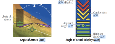

?? AOA display on Garmin PFD - GDU465
I have a G3X suite installed in my RV-14A and am going through configuration of the system. The part that I am working on now is the AOA configuration. The pieces concerned are the GAP26 (Pitot/AOA probe), the GSU25 (air data computer), and the GDU465 (PFD).
After reviewing the configuration instructions for the Garmin AOA, I am sorta-kinda-certain that the AOA tower bar graph will display on the PDU, but I have not found a picture of a screen display in any Garmin marketing or Pilot's Guide depicting that.
Am I correct or is a GI260 (AOA indicator) required for display of the indication?
If anyone has a captured screen shot of the AOA indication on a PDU that would be helpful.
Correct -- it's displayed on the PFD; see the pilot's guide, page 88. Picture attached.
Thanks Brian, I have looked at so many docs pages, I probably saw this a flew right by it. I'll review.
