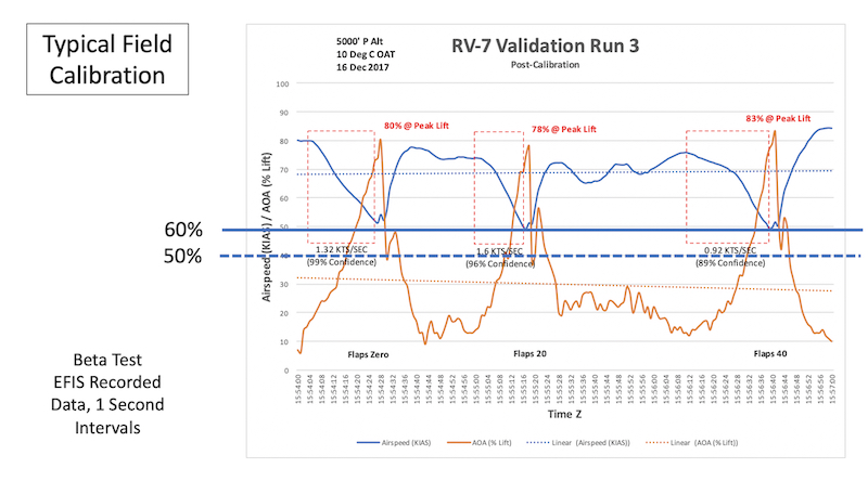

Short answer: fly some practice approaches at 1.25-1.35 times Vs Flaps 40 in still air and note the indication with your current calibration. Dynon has a selectable tone pattern; so, pick one that covers the part of the graphic that is lit when you are stable at that condition. Whatever that graphic/tone combo is your ONSPEED cue. You can repeat the drill at best glide speed, flaps 0 and that’s your L/Dmax cue for your airplane. Because of the way the Dynon calibration works (especially the older DY-10/100 systems), it will be hard to get your display to have ONSPEED correspond to say, the middle of the yellow chevron.
Long Answer: The Dynon AOA is a good progressive stall warning system; but it doesn’t appear to be designed to provide accurate performance cues (i.e, measure actual AOA accurately throughout the flight envelope). When we used the Dynon EFIS originally, we had a work-around that used an off-board processor that read the percent lift signal produced by the EFIS. We simply used a percent of a percent (i.e., a simple ratio) to make the tone work.
If you download your Dynon data into a spreadsheet, you can look at your percent lift plot. It will look something like this:
You can see the stall is occurring at about 80% total lift in this case, not 100. Now ONSPEED still occurs at 60% of peak (i.e., .6 x 80%); but I don’t think the Dynon graphic display makes allowance for this. It appears to be a simple look-up table (i.e., at X%, light Y graphic), thus my recommendation to use the calibration you've got instead of trying to chase a perfect calibration or calibrate to get your graphics to line up (if that makes sense).
Good on 'ya for using the system you've got! Hope this helps, but if it's clear as mud, or you've got more questions, post, drop an email or PM. Happy to help if I can.

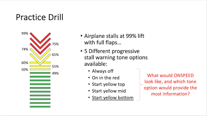

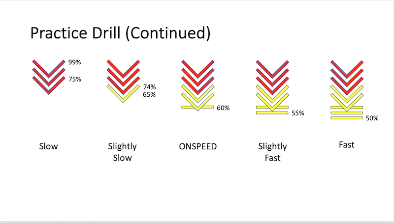

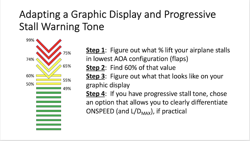

Figs,
I found some old slides from our OSH briefing in 2018. If (big if) your Dynon is measuring 100% lift during stall with landing flaps, then the first two slides apply:
This is our best guess for the Dynon % lift associated with the visual display on the 10/100 EFIS. Now in all likelihood, you are NOT getting 100% lift at stall (see graphic in previous post); so the logic I laid out in the "short answer" is summarized on this slide:
Hope this helps clarify. Offer to help stands, if not.

Thanks the charts are really useful as I can go fly some configuration runs and select the progressive tone start point that results in a distinguishable tone at the approximate Onspeed point. Also looks like at that point there is still some margin to react if taken by surprise due to rapid onset.
Only issue I can see is whether the tone will be distracting/annoying as it will likely be on for longer than it currently is.

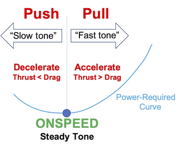

What "Bleeding Energy" Sounds Like
If there is more drag than thrust, the airplane is going down/slowing down (or both). One expression for this is "mushing" or we say we are "on the back side of the power curve." Fighter pilots have an expression for this that I like better: "bleeding energy." Intuitively obvious that bleeding energy probably isn't a desirable state.
We use this diagram to show folks how we can integrate an energy cue using an AOA system:
We use the tone to cut the power required curve in half. If you are ONSPEED, thrust and drag are balanced; but if you hear slow tone, there is more drag than thrust unless you do something. What makes the logic so simple is slow tone = energy bleed. RV's give limited aerodynamic stall cues at 1G (i.e., not a lot of buffet, stick force lightening, etc. prior to the break). This means the airplane can feel solid, but you are actually bleeding energy (and getting closer to the aerodynamic limit), perhaps without realizing it.
Here's a classic example of a square corner after a low, slow final overshoot. Hard to miss the energy state with the slow tone barking at you:
https://youtu.be/Usu2aPhJeJ0
The F-104 a few posts back would get the same tone on the top of his 10K' loop if the pilot pulled too hard on the stick. What's neat about these cues is because they are based on AOA, they work at any G-load in any attitude--no cockpit math. Slow tone = energy bleed. Caveman simple.
We call the graphic a "push/pull" diagram, since that's what the tone tells you to do with the stick and power controls.

OK I did a few runs yesterday and it look like if you set the Dynon tone onset at the beginning of the yellow chevrons you end up with a solid tone at the beginning of the red chevrons and still some margin before the actual stall break at the top of the indicator.
So onspeed from the pictures would be close to the solid tone. I plan to try this for a while but suspect the dynon tone could get a little annoying as it will be on a lot during the approach and also after landing until you hit the MINSPD setting and it is not the most pleasant tone;)
