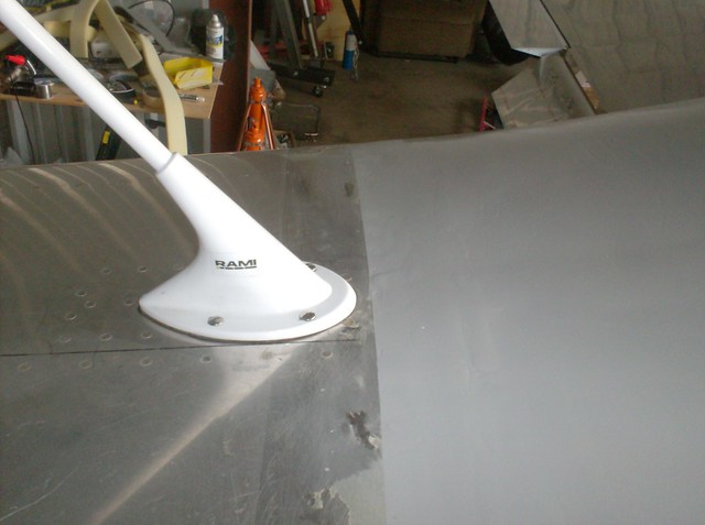

Ok, same question I think applies to the AV-10, to center it, you would need to drill through a J-stringer correct?
Opps, sorry about that. I offset mine. The doubler inside the tailcone is abutted up against the stringer, but I did not drill through it. I can't find a pic of the inside but here's the outside:
Note, this close to the cabin top I extended the ground plane onto the cabin using 1/4" copper foil embedded into the fiberglass.
Be careful when you attach a doubler in that area, it is not flat, and the doubler will cause the curvature to flatten out. I mounted mine in the same location and in the same manner using a small spacer to maintain the curvature of the fuse.
