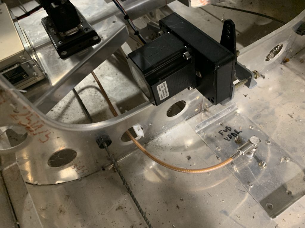

I’m putting in two com antennas and a transponder/adsb antenna. I want to put the com antennas in the footwells. How far back from the spar must it be to not interfere with the pushrod for the ailerons? I assume if I’m aft of the pushrod hole all is good? And does the depth of the footwell get in the way or do I need to go further aft to avoid footwell interference? I don’t ha a delta-pop in hand to physically check it.
Is the best place for the adsb/transponder antenna aft of the battery?
I located mine with the BNC hole just aft of the pushrod hole; this, in turn, places it just ahead of the low point of the footwell. If you look at this photo you can see where I drew the profile of the footwell on the outside seat rib for reference when I was locating the antenna. I'm also going to use 90° BNC connectors here for good measure when it comes to clearance.
I put my xpdr antenna just aft of the bellcrank, in order to maximize distance between it and the com antennas. Dynon wants at least 3' between them.

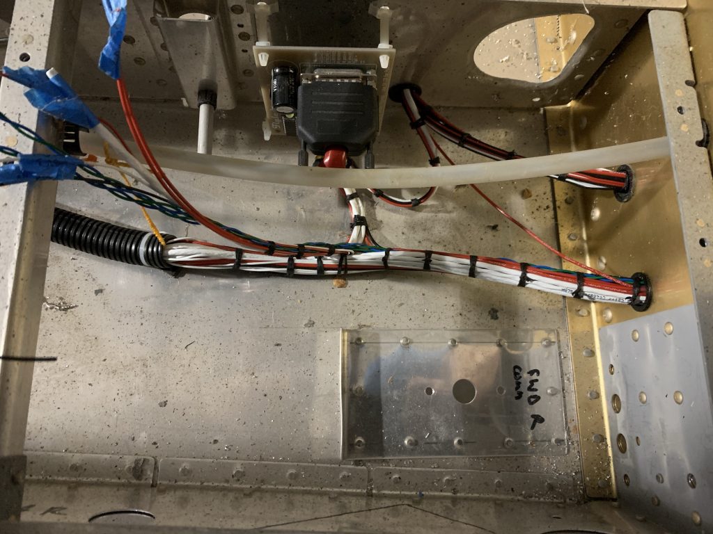

Ironically todays project, and mine turned out really close to Philips. I tried to trace the footwell on the lower side skin and split the difference between the pushrods and footwell

I also mounted both comm antennas under the rear seat foot wells, but mine are aft of the foot well low point.

I didn't think to do it before putting on the bottom skins, so now I need a rivet helper. Seems like I've seen some pictures of installations with a doubler solely held on with the antenna screws. What are the tradeoffs of that?
I cut the holes for the transponder blade tonight. Nothing has been permanently mounted, but I can get the skin to flex side to side and can see how riveting the doubled skin would probably help. Exactly for the reason you mentioned I hoped that wouldn't be the case.

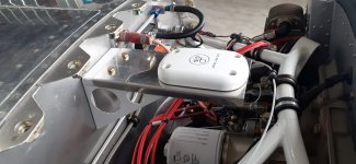

Here's where I put them on my 8
1) Comm 1
2) Comm 2
3) ADS-B In
4) Transponder
5) SV-2020 GPS
6) Avidyne GPS
Placement takes into account the requirements in the Dynon installation manual.
I also have a Bob Archer Nav antenna in the right hand wing tip for VOR/ILS and the ELT antenna is in the passenger's right hand arm rest.

Antenna Doubler - Bond It In
You can always "bond" in a doubler using a quality epoxy adhesive - 3M ScotchWeld 2216, Hysol EA9430, JB Weld, or equivalent.
I've done more than a 150 destructive joint tests using (mostly 2216) epoxy over the years, and found it provides a greater ultimate shear strength (per unit area) than a -3 riveted joint using 1 1/4" nominal spacing. Its only drawback is low peel strength - but in the case of doublers, there shouldn't be enough flex at the interface of the body skin and doubler to generate a peel type "failure".
Just Sayin' ...
HFS
The drawback of adhesive bonding is the lack of electrical bonding.
You lose one or more electrical bonding points from the fasteners. So, the antenna base to belly skin is all you have. I like the redundancy of multiple points.
