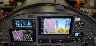

For a SkyView (and I assume G3X GPS antenna/receiver) this is no need to paint. Just cover with some dark cloth, tucking the edges under the antenna to hold (see photo). I’ve done this for all the SkyView installs over the years.
But do not put a GPS antenna for something like a Garmin GTN-650 on the glare shield. Garmin install instructions provide guidance on what they want you to do to mitigate known issues. For RVs this translates to the Garmin GPS Navigator antenna mounted on the top skin aft of the cockpit. For the RV-8 a good spot is just aft of the rear seat but still under the canopy. This allows for the canopy to slide as needed.
