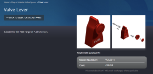

They can have it to you in 10 days max, I've ordered many parts direct over the years and arrives very soon. BTW they don't do e-mails well at all, if needed call in the morning their time.Has anyone experienced this kind of wear?
It’s made changing fuel tanks impossible
Aircraft spruce doesn’t sell it as spare, advised to buy new valve
Waiting endlessly for reply from Andair UK
Any remedy?View attachment 115675

ThanksI contacted Andair since they are local to me. They said those pins are a close fit so it's tricky to remove them, the options you have are to machine out the pin and replace but this is difficult as it's a precision part. Alternatively they can ship you a replacement knob which shouldn't be expensive. I have DMed you with a contact email.

Don't think so. You pull the knob to turn the fuel selector "OFF". Switching tanks is just done with a turn of your wrist. That way you can't accidently turn the valve off.Every time I change fuel tanks position, I pull the knob and turn it, I think that is the way it is supposed to be used
I think after review of your knob operations (Don't pull the knob up to change tanks) you have found root cause. It's critical to get the knob exactly positioned so the suction side (3/8 in) gets perfectly aligned. As other have implied it too much of a coincidence. Our 3/8 in suction side tubing is marginally ok. Cirrus went to 1/2 in after a few years because who knows but I will speculate 3/8 in its marginal. Most likely (speculation) you did not have the knob in a "perfect" orientation, and you were getting suction side cavitation which destroyed your Walbro fuel pumps.Has anyone experienced this kind of wear?

The locking pin has nothing to do with this wear. That white round pins purpose is to lock and index the knob to the shaft. That pin is supposed to fill the gap from the flat machined in the shaft. I just don’t see how this got worn the way it appears in the pic unless someone jammed it own on the round part of the shaft instead of the flat. You can’t apply enough rotational force to shear it off, as the shaft has no resistance. The locking is done via a different pin riding in a slot in the body.I think after review of your knob operations (Don't pull the knob up to change tanks) you have found root cause. It's critical to get the knob exactly positioned so the suction side (3/8 in) gets perfectly aligned. As other have implied it too much of a coincidence. Our 3/8 in suction side tubing is marginally ok. Cirrus went to 1/2 in after a few years because who knows but I will speculate 3/8 in its marginal. Most likely (speculation) you did not have the knob in a "perfect" orientation, and you were getting suction side cavitation which destroyed your Walbro fuel pumps.
Larry, my point was I don't believe he is getting the valve turned to the exact position to allow free flow of fuel to the pump. My theory is this is because the white pin is worn and difficult to "feel" the correct position when it is rotated. (Especially when top knob is pulled up) Possibly a clearer meaning of "It’s made changing fuel tanks impossible". I took that as the valve is difficult to rotate and possibly difficult to "feel" the correct position.The locking pin has nothing to do with this wear. That white round pins purpose is to lock and index the knob to the shaft. That pin is supposed to fill the gap from the flat machined in the shaft. I just don’t see how this got worn the way it appears in the pic unless someone jammed it own on the round part of the shaft instead of the flat. You can’t apply enough rotational force to shear it off, as the shaft has no resistance. The locking is done via a different pin riding in a slot in the body.
After looking at the picture, it appears the pin is smashed, not smeared, so I suspect that someone did just like you suggest; simply placed the lever on the shaft, did not find the indexing feature on the shaft and just cranked the screw down tight, destroying the pin in the process. At that point, the ports are forever misaligned (partially obstructed) compared to the lever. That's strike one. Exacerbating that, is the improper use of the interlock knob which guards the OFF position, but more importantly provides positive positioning for the LEFT/RIGHT operating mode. Without the positive stop, the operator is using visual cues to position the guts of the valve, which also contributes to partial port blockage. That's strike 2.The locking pin has nothing to do with this wear. That white round pins purpose is to lock and index the knob to the shaft. That pin is supposed to fill the gap from the flat machined in the shaft. I just don’t see how this got worn the way it appears in the pic unless someone jammed it own on the round part of the shaft instead of the flat. You can’t apply enough rotational force to shear it off, as the shaft has no resistance. The locking is done via a different pin riding in a slot in the body.
Agree completely. With that pin worn away it will be difficult to get the shaft to turn. Sorry, thought your were talki About the causeLarry, my point was I don't believe he is getting the valve turned to the exact position to allow free flow of fuel to the pump. My theory is this is because the white pin is worn and difficult to "feel" the correct position when it is rotated. (Especially when top knob is pulled up) Possibly a clearer meaning of "It’s made changing fuel tanks impossible". I took that as the valve is difficult to rotate and possibly difficult to "feel" the correct position.

I've got a spare knob if you need to borrow it till your new one arrives. PM me if needed.
Some updateI contacted Andair since they are local to me. They said those pins are a close fit so it's tricky to remove them, the options you have are to machine out the pin and replace but this is difficult as it's a precision part. Alternatively they can ship you a replacement knob which shouldn't be expensive. I have DMed you with a contact email.
Some update….
No, the installation was not done correctlyJust to understand your post - the Andair valve was manufactured incorrectly, perhaps destroying your fuel pumps in the process, and they want you to purchase an additional part to make it work?
