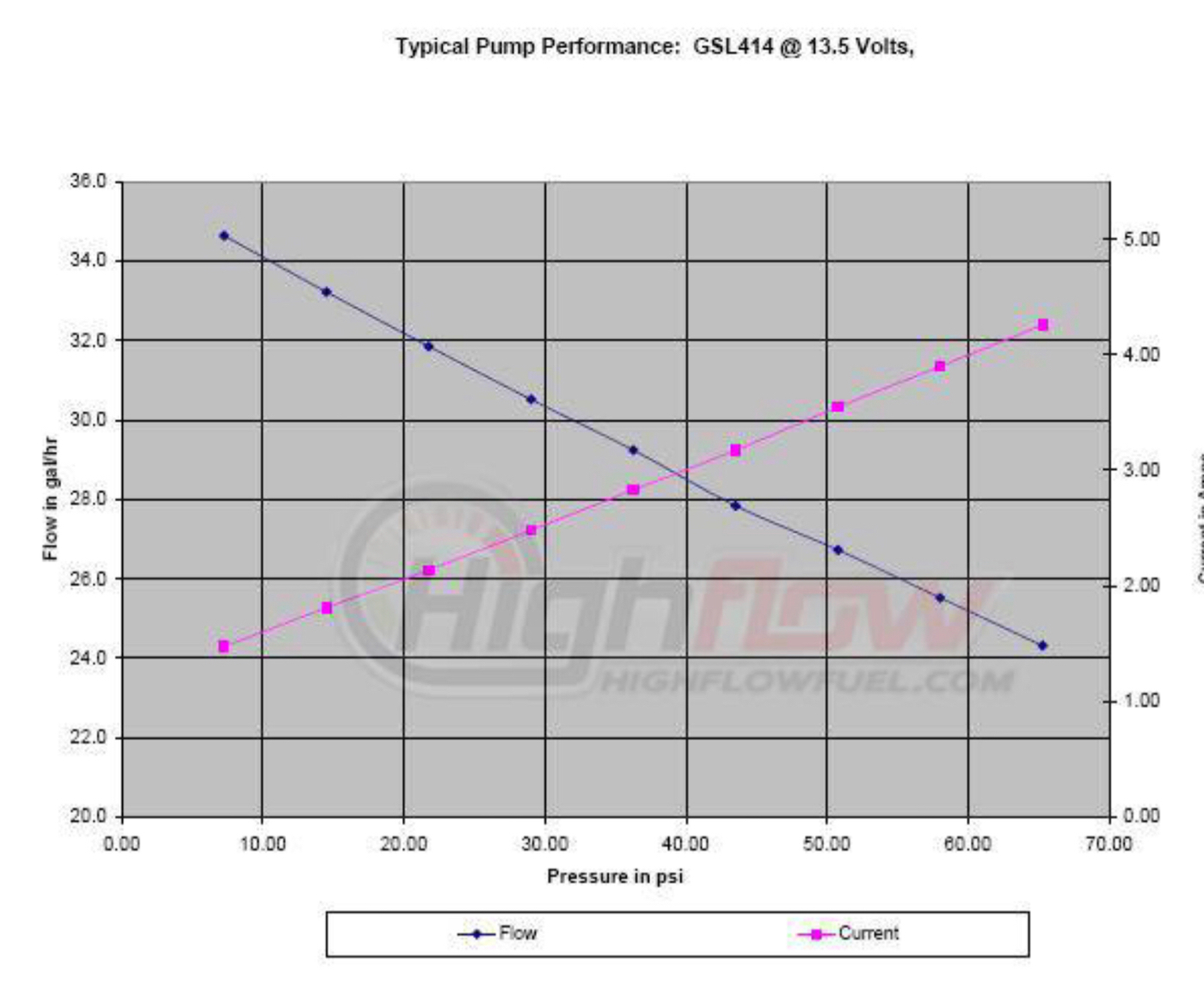

I'll be clearer: 22psi at a full throttle, sea level condition of an O360 (16-17 gph) is not adequate. Yes, the engine will run, but the engine driven fuel pump will deliver in the high 20's psi at that flow rate.
The second part of my question was the apparently incorrect or incorrectly obtained data by the manufacturer. The graphs of 12 and 13.5 volts should not cross, unless there is some new mystery to DC motors and constant displacement pumps that I've not heard of.

Alex- I agree completely with everything you say here. With both pumps operating, which will be standard proceedure for TO&climb, I should have ample fuel flow with a huge surplus. I can also operate both pumps continuously anytime and for however long I wish, so would do so during aerobatics as an example. In fact, the only real reason for turning one off would be loss of the alternator, but I?ll probably run on one pump during cross country cruise just to lighten the load on the alternator a bit.
This installation will be analogous to dual mags- two for normal ops but one will get you by with a little judicious management. I would anticipate a similar rate of serious malfunction as well(quite rare). Just as with mag checks, runnups will include verfifcation that each pump is fully operational, and I would no more take off with one pump inop than I would ignore a bad mag check. The redundancy of this pair of pumps will also equal that of dual mags. Each pump will be powered through an on-off-on switch with direct, full-time access to either of the two essential loads busses, each of which will be hardwired to one of the twin batteries. Yes, you must turn off all pump and ignition switches as the essential loads busses will be ever-hot, but I have a good solution for insuring that.
The graph is from Walbro, and I agree that it does not make sense. I will be be doing extensive bench testing with Stoddard solvent before istalling this particular pump, and will report back with my own data. Thank you for your input!- Otis

I was told today by a Walbro tech that their pumps are NOT, in fact, roller vane but geared, which could explain their higher reliability and their superior self-priming ability. Within a few weeks I will be doing some extensive bench testing on the GSL395 to determine its suitability for Bendix-type FI systems in a dual pump installation, and I will autopsy that pump to verify what I was told today, so at some point there will be an”anatomy a fuel pump, part II” thread.
Btw- the Walbro tech agreed that the published graphs for GSL395 performance are flawed. For example, he looked at the raw data for the 20PSI pressure point, and verified that at 12V flow would be 29GPH but over 40GPH AT 13.5V. The graphs indicate anout 27GPH at 12V and just 19GpH @ 13.5V, which is absurd!

Your statements about flow vs pressure seem to contradict reality. Given a non-changing supply voltage, a positive displacement pump's flow will not drop with reduced pressure; it will drop with increased pressure. As long as the pressure isn't above the pump's design point, the pump itself will flow at least the quantity of fuel shown in its ratings.

Charlie- I do not see anything I’ve suggested that contradicts what you are saying here, but I think I understand the confusion. I was referencing the erroneous nature of the performance chart published by Walbro for the GLS395. 30PSI is indeed where the flow falls to zero for this pump even at 13.5V, so my task is to insure that sufficient flow remains at 25PSI for my needs(with two operating in parallel for high-flow operations). If you go all the way down to 20PSI there is ample flow for my needs with even one pump, but I don’t want to push the Bendix- type fuel metering valve to its lower limit, so will target an operation pressure of 24PSI per AP instructions. Clearly, the GSL395, even two of them operating in parallel, would not suffice For any EFI system I am aware of.- Otis
"The concern about the GSL395 is that flow drops off pretty precipitously below 30PSI" and related statements are what I was referring to.
Are you trying to say that it drops off as pressure *increases*, approaching 30 psi? The wording sounds like you're saying the opposite, and is reinforced with the statement following that it 'would be ok to operate at 25 psi'.
