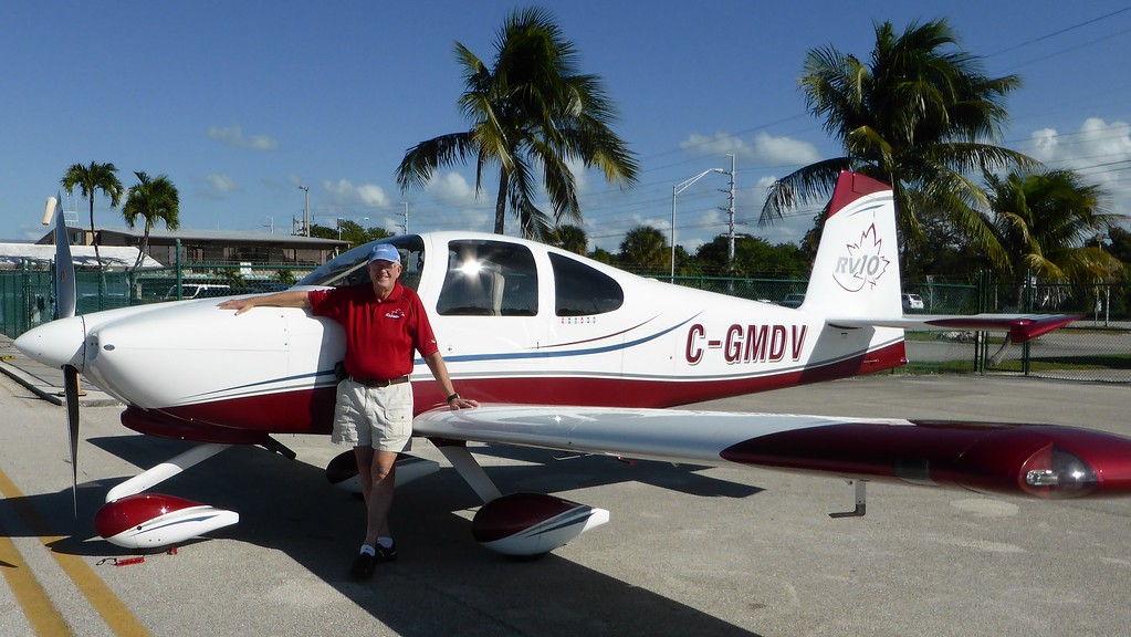

The picture was taken at the Marathon airport in the Florida Keys about a year ago.
