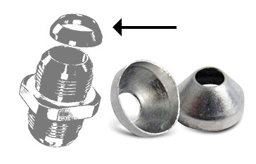

I've been applying Permatex #2 to AN threads.. does it also get applied to the nipple/flange side of the fitting as well? (the side where a flanged tube mates to the fitting with an AN nut).
I don't think so? I don't see how it would prevent a leak on this side of the fitting.
No. Only on tapered, NPT threads. The AN side with the 37 degree angle seals dry on the 37 degree face. If the faces are slightly mared and cannot be easly replaced, there are ̶t̶e̶f̶l̶o̶n̶ Aluminum tapered washers you can install in between.

No. Only on tapered, NPT threads. The AN side with the 37 degree angle seals dry on the 37 degree face. If the faces are slightly mared and cannot be easly replaced, there are teflon tapered washers you can install inbetween.
No, not tapered teflon washers. :)
They are formed soft aluminum seals and should be able to repair marred surfaces on the 37 degree angle faces.
https://www.aircraftspruce.com/catalog/hapages/del37fittings.php
Putting a sealant on the AN threads 'can' allow the nut to tighten before the 2 seats make sufficient contact. Leakage will occur in most cases.

... soft aluminum seals and should be able to repair marred surfaces on the 37 degree angle faces.
I carry some of those "Del fittings" in my "parts bag" on a long cross-country. I'm not sure why, but it seemed like a good idea. :confused:
