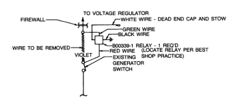

Thanks to Mich48041 for finding this Beechcraft Service Instruction SI 1062 showing what the B00339-1 overvoltage relay is and how it is connected in series between the alternator field switch and the voltage regulator. AFAIK this overvoltage field interrupter relay comes from a former time, before overvoltage crowbars. Relevant image snipped from the Beechcraft SI attached.

It would be a good idea to verify the function of the overvoltage relay, the Beechcraft SI 1062 says it should trip at 16 +/- 0.2 V. I personally would use an adjustable power supply versus the engine-running method in the SI.
