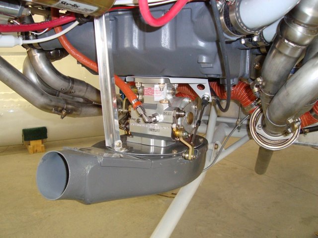

I just use two part urethane paint I had on hand from the RV-10 paint. Just like the cowling, I want the fiberglass sealed up and finished with a durable glossy urethane paint that will not absorb any fine oil mist and can be easily cleaned off with either a solvent or non flammable cleaner such as Super Clean degreaser.

Perhaps, but I seal all cowl and FWF fiberglass to protect agains oil and such. And yes it is cosmetic, just like painting your plane.
Take the little bit of time to paint this along with baffles and such. You will have a much more “finished” look.

How come your top plate flange sits outside the airbox instead of inside, curious as im working on this now.
If you flip the top plate over you can fit an K&N E-1000 filter (same diameter as the stock filter, just a bit taller). The idea was more filter area equals to less pressure drop across the filter. I also found that this complemented the James RV-10 cowl to line up the cowl engine air inlet.
