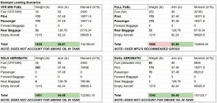

Like you said, your airplane is how YOU want it, so what does that leave you for utility....
I included several example loading scenarios. These weights are for your airplane, and the wheel stations are what you reported.
First: Empty Aircraft
Now, lets load it up...
Not knowing what you or a partner might weigh, I threw the ol' FAA standard's in there. You'd still have 53lb of baggage, which isn't bad for an airplane carrying an extra 100 lb of equipment... For the solo aero, I eye balled a parachute and helmet, and figured you might have a backpack or tool kit strapped down in the rear. For dual aero... it's more of a "take the grandkid for a loop" kind of loading.... Interpolate how you wish for these.
Now, for the sake of "what can you do". Lets say you didn't already have a lightweight tailwheel (about 1lb savings) and you shed another 2 lb with some lightweight tailwheel components *cough cough* for a total of 3lb reduced tail weight.
That'll set you up for an extra 12 pounds of baggage! And probably a few more years of flying aero with the grandkids...
**EDIT** After posting I saw your actual main/tw arm lengths. Updated the figures to include your stations/arm lengths.
