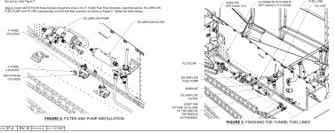

Hi All,
I am wondering how the AFP fuel pump/filter assemblies mount in the tunnel on an RV-10. Is there a standard way of doing this--do I use the Van's supplied brackets or is there another set of mounting brackets I need?
I bought an engine that has an AFP FM200 system (servo, spider, injectors) already installed, but I don't have the fuel pump, filters, etc. as the engine came from a flying RV-10 and the owner was keeping those components for the new installation.
I just realized I need to make a decision about whether to install the factory brackets. I guess I could install them and remove later if need be, but that seems a waste of time, if there is another preferred mounting scheme.
Also, related, how have people mounted the Andair fuel valves--the one I have doesn't seem to fit the factory bracket without modifying the bracket; I'm wondering if I should just fab a whole new bracket or modify the factory one?
Check out section 37 in the plans for the AFP pump and filter install.
I didn’t install the AFP filter and just left the bracket in there behind the pump.
For the Andair valve, I just chopped the already installed bracket and riveted a new 063 plate in there to suit.
All pretty straight forward. Access is reasonable at this stage of the build.
Consider the access plate in the side of the tunnel if you haven’t already.
Thank you! I don't know why I didn't think to look forward to Section 37--I didn't realize Van's had published instructions to go with the AFP system.
Also, thanks for reminding me about the access cover--I definitely want to do that, and had forgotten to buy it or fab one up.
