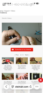

Not sure if anyone recalls but some time ago I posted about my left strobe going dim. I fiddled with the wires and it got it back working so I ziptied them to keep some tension on them so they wouldn't jostle around and it worked for a time. Anyways it stopped working again so I reached out to AeroLED about getting a new connector kit and they sent me one for free which was awesome.
I watched the YouTube video for install and it seemed easy. Well like most things that I try for the first time it was anything but easy. Nothing seemed to fit or lock into place like the video showed. On top of that, my markings on the wires rubbed off so then I was left trying to figure out which wires went to what. 2 blown fuses later I finally had it figured out, managed (I thought) to get all the stupid wires pushed in and locked and put the male and female connectors together but when I flipped the switch the strobe didn't come on.
I had loosely connected the wires prior to fitting everything together and everything lit up like it should. I remarked everything, took a picture and video to ensure I wouldn't mess it up again. So I'm confident that everything was put in the right place. But these new connectors seems so overly complex. The old molex connector was a simple piece of plastic that locked it all together.
So my question is, does anyone have a utterly simple solution to connecting these wires? Any reason I can't just go to Lowe's and get some molex connector and just slap it all together? Or even just splice the wires together and slap some electrical tape and caps on them?
TLDR: I need an easy solution to connect the wires at the wingtip for my aeroled light because I'm too electrically/mechanically challenged to make it work.
I attached a picture of the old connector and the new connector.
