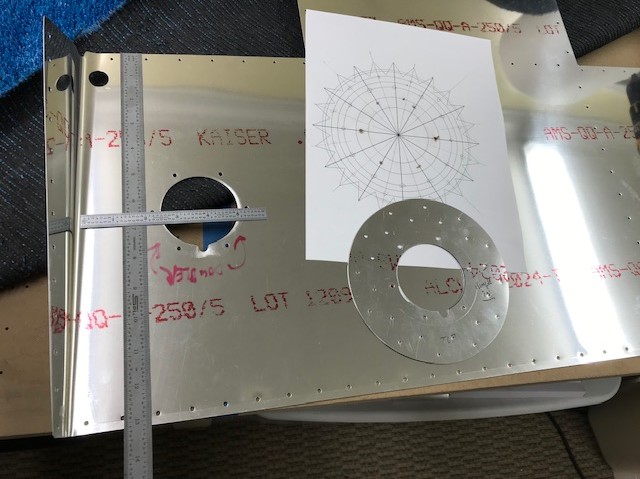

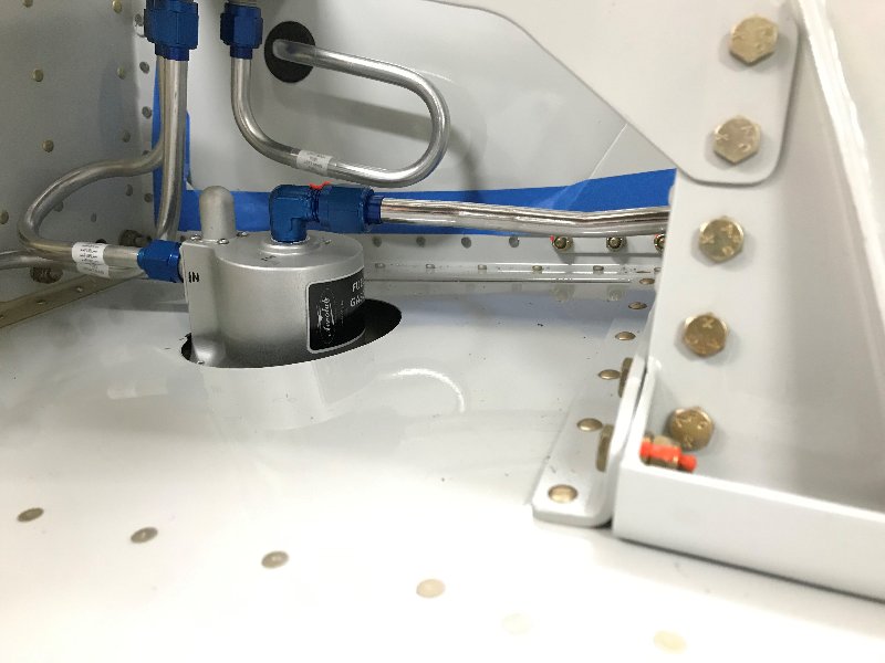

RV-6 installation completed
First I would like to say that Francesco has been outstanding to deal with. This guy typifies the brotherhood of recreational aviation and his attention to detail should ensure this new gascolator is a winning product. A top bloke. A great product. I wish him well.
Installation into the fuselage was very simple and in total took me about 1.5 hours. The stainless steel template available makes hole placement a breeze. Due to a combination of orientation and skin thickness requirements I ended up making a 0.032" shim which is riveted to the fuselage to ensure a nice flush finish on the outside. The result is a very tidy installation with easy plumbing to the fuel system.
I've mounted the gascolator just forward of the Fuel Selector, in the centre of the fuselage and forward of the main spar. This is almost at the lowest point in the fuel system. The only downside is that I will have to crawl under the fuselage during Annuals to drop the filter out, but hey, if that's the only downside then I'm still way ahead of my original plan.
Why did I go this way? I wanted filtration prior to the HP Fuel Pump on my Airflow Performance fuel system. As an aircraft engineer I know the value of keeping these pumps free from dirt and grit. I originally planned to place an Andair Gascolator in each wing root but it's not the ideal location due to limited space and this also requires complicated plumbing. Having maintained an RV-6 for many years I know how much fun it is keeping those old fuel selector valves serviceable and I just hate the smell of fuel in the cabin, so having any open fuel source inside was never going to happen for me. The Aerolab Gascolator solved all the problems in one hit. A single gascolator mounted inside, close to the fuel selector but inspected externally. No chance of fuel inside the cabin. Easy plumbing. Easy maintenance. No brainer.
As a point of interest - I actually considered placing an Aerolab gascolator inside each wing tank for a while. There seems little reason why you couldn't do this however it's a bit of an overkill, adds weight and adds cost - but I have no doubt somebody will have a justifiable reason for doing this one day.
As for the expressed concerns over the little red button...? You'd be better employed worrying about the possibility of a zombie apocalypse than whether or not this will affect your performance.
Mike

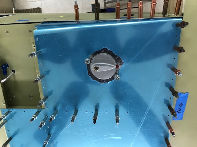

RV-10 Installation complete
I have been helping another builder here in Oz who has also chosen to install the Aerolab Gascolator/Filter in his RV-10.
_xG_k93DGup5Vd_EWhTdqhhKoVZJwywIhag7c4epzIGIYApxiP09JTqn8Dc3gpHlThQlIn5XdbUTEaMY8qfhAq0nR4vtmCyPG1rQz2YSJ4ekS_0Jmm6xfE7LgHhFEHCZT4wJZCYQqwsEE9_0_sR0deGUT3fdrYxaOOZUJnkDXYhocnsH65k9-i3GkAiiocengEaelyyfl-JhrYkJIwrwBms_omdQQeHf5cx7IlggnyFncYVGhMg943WtuqD4b0IbpUxj_yP84aU-fxkOjMRRl4JYfQZomiS_O8DH8GwGCyxC5n3W2TCYxgQu-RTxWtrSbW8h0z5DSbETVM8-JHFF0HH-KsFHK2HFvx_lphzf1pahHzsUFdexBe98xvzjg8mUpXNuoQwwthiGcV8fKdq8aZtYjuq-IRbtZeOLRuR-9VOCEokrDJpKlTR2V0BRKovSw0t7414i8NqWQQZ-Ymho4Md_xlRjKf3Oem58AmWwFUPBei_zg44CQhSE_dYy-GtGmhsG9hC9bZjMXgV87ctrw-Sh-LOYXKc7pq5x1DX8xQTMZFljbIdUOpiE36yXrDms9NVzQ2RtC4SlAZrrZFy6ZYkb5s5OqnO5HxgaKgY9pnx3cZ6CLYi-3aVv8xTrQN6BYKk2ry6ReV-625P9z-WYlCcT9WXTYuYFvxzKqYaJZDM=w894-h670-no
The installation in the RV-10 is very straight forward and Mike's previous post describes the installation very well. The stainless steel installation template is the key to making this install a non-event.
Accessing the fuel filter from outside the aircraft is going to make inspections and servicing a lot faster and easier.
k7KCQQTnKkL21DxuX943oGHSX00Gxcqw7Jxch6D8URC1NCLUUCpSgInhSzKiR5DgSATF4AQPZ7yUSoUO1GHa39YTZb64tKqeMVE1sb1_IAUKPznO8lbubdaC-3dP_Huay22RJ24HxBqWFruEUovZ89TZGc9wA76Eouiuc2Lit7I-Mp7erOeYuyu66AwXSplfPG9dhTlHp4xbPT8VOjleAmZ793ipm_M8rtHRDzs7Tm8E8TSe3VKqFtV2UL-R4BKp7W3S1-Miy1Lqef5EOuF2UqpxrWuoww97Jg1bIXL6iUxNaTE-ksGgn_Nc4tbY8gXSsGYs378UnE8NXELQqSa3h31V1FdE9FLe-Wv7nogfvmS2dR0LBIRBCB65TYsAS-WGNtIbUKo1xjjuwdb0HbqLHGnfXGz1GjsvPD9et62D691i-5LB6ZsnH9FewZkv-6xDDoH2pyjQQXI3cf-8nrv0dFSZqB471xMM9eJ0n-qrOME-FEnQ2mmYAkhkZmcN4mL9qcJhKujEeXNwM7Akp-HntZv8rnn3W37iXx6IPLt-cFrJPNs5nbDaY07oSGCkIuPr5d8LwFKvcDPc74W_Q-jqcXrtu2flkj94ruZcQ6ifIvM42vi9aIz3SfdIWM51sSa7hVHjUczihJ18hXFEGlsjJwK4VkS676p4IiTsM0r_poI=w894-h670-no
The install in the tunnel is very clean,I like the added benefit that with the Aerolab Filter installed,none of the fuel fittings will need to be disturbed and re-torqued on an annual basis as with the standard filter installation.
AvAnKTFHmH8qW9C66kK3K-P7iLP99Qm82mCkqOl6WQB9S6nwDI5oIZjLVJIqz6zoaR6FeqHz28S2JE3RGe3adg8-WWutXh04YUS9XjJOlllwVvM8-J3PSkEp7mJ-lCeGYfK-psdSy7EzeHvsyDEeWWGCO2CCzIxdAx64Sz7iy99xuOjvTRWZkaClMfiugBFp2AhcmDeiPZ4FiimeumTdpC_3WH2wUg4zbBnTSq_GGV0GxeKT4-SXrVx3jsTGNnIa6cePD7rrXDqnzgbGTzJik-rIwduMbfihPW1rsx1xytTuyC9RWKs1wnoPIQjlKip76SjrLTA1jYClsKnSZ7tpRWR9_rSVPGkbSff1G5aZsZlmjfJDLm6Kh5KoE6OfThw5L0GMOt6vj_seXMIJzlRR5JV3cxViNwl8dg3Rj5sjILi4CGUxNqeVTFKavnibwIiNHz9qf6kl9bFr73Xdlg0JVqSrfcYpndXfYVwT3ixr_vx1MfSg9Kj4x3OpeSpF2bQMaqEP7L5lxj3yMsMuW9v7HOfFJRcU9J2FxLStNgtKQLK5yn_G_Jq-3LymEjc8JAXADOFp-tSdQW77xBljPuy7xjnXM-HY-qF3JelVQRpCg9kx0FUvPPCg5kBYUdWhZfGjo93LeWkRGLo8GOTabybUlzmNkMxIHc59Y4Lq8qqTaFA=w503-h670-no
ZOI1DJUHw3vPp8Nv61WNPMy5_w5cgLDR31DKXosrSNkSc4ai0WNFBQ5EwXNqBuqE00O5rzpxVRx68bJYKjT1tys-ss2Z3uC0hE-ovIPCyyU0gn8Cb1VYyytQoH_E17lt3MgRDPqhb2Vgv6ICCzhkR9PMsW_fgbC_kptVgf-6T3RBpDUf1xTO1f8-rinwQnGPSYv4xjahsHf9-wFIISjx45JihxkcrBUUFboKsJx3lhapNS9WfccW7bGDaPr7m8Ay-SQeNdSeyBRzXytpxJqv-Rq4enHRdn1JL9wo77na7Zpw5d28bPulRn8rjLP8xWLfBrGCztKdm1g0MmPplmrKymaZhdk6UH5bnlQdRBJUMn_AuCIAwtugZZxtcHQZ-jnIbXtDpG_j7KJz7brqlE8oPuTv1u7G_Ekce-swyK965M9lj6GzFScq12_Tz3i0dOVzOdnJ6hckPIFR8NDiBVKczhbICFRA2FnT0xOkUM86s_bG7uHQQKMFalfDEb3xT0kix_mRKZbl9ztBOLiU1hSOWPNqFDRJVzXgL3Ydf_K_gs2jkHyC7D2qJy8K4ZEwv4hUJEwItMwYgYBzlOqcnzmUE0IYQn3BaRCUmTzyYl7MnrrJ0x0r3HL1ByO6YBB6yE-9Wi3GZzTxTGAb8K5paHRrZAiE4KOBR-n6nPVkuu43m5M=w503-h670-no
umQ6n8xXn0brY2SzN9Rkzopof1sizIjSYeJgzGpPcVyrN_pVds55_bMYHS07uvD4OXb1gq2i1aH6VszM_TJ0EmnBpO4QP4Fmdh541-SVKNVzdJnIPMt_TNlJYfzcGfDSBLx0SABT_VVdn6raQTu9PDnYe8YIxVH7Ix7vp0siPRu6czKxC5EIt0ylR8VmNPpgFILhO_6QjeYgqjM1Ca_WxO7_-xz_crBg2tImnD3WyHZdW2hcoEWLEZ4ChV5yGmgoc0hLUs0Z8V2tiuFdvvqf6bSE7H_QvUzp-GittDjO7EyyB-z9OVmiGuna5Hx8EhMr4D6uhRb0rnBIs21RZuLkRGvPp4Fqt9H0E1WlHuWxXZZiWLqk7eo09TCJaZHNIACxEx7b30UiFadCIVYRE_Aqds1pXPF1duk-LDWxhzfac2CRCderjb2p9IjB3mIwdGx9zFmTSbOKYzohhEJsVgtTW3vRztaWZFlFyxd_ixTP8C_RfumGsy-7e8ma4D_kwdvKreYWlcw7MjZ735vms5Gi5SYEmw2ocsKTG1KXunu2LBj3FeGq5onzclZkH-TqCrOTnA5zO-c622y7lkpeHL836NAJMro-bSdw7DQsUzK4-M_qcF1fgkMLpg5v-t8_5fXvTE7-6XRdTS4N_-Lahz4XiQqlHXztXmVpzirDBADSWbM=w503-h670-no

RV-8 Aerolabs Fuel Filter Installation
Thought I would post a couple photos of my installation. I added a circular doubler to the belly skin. The unit installs from the inside, so the floor panel hole has to be big enough to clear the whole flange. you can see the two pre-punched holes in the floor panel that give you an idea of the location of the hole in the floor panel. I will add some foam around the hole to keep anything from falling in and being lost forever! Just have some packing paper stuffed in there now.
a little Visio pattern for the doubler layout and some scales showing the approximate location of the cutout.
