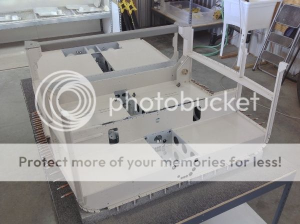

I am point in time where I need to paint the interior. The Finish Kit has arrived and I am almost ready to start on it.
I have the full interior package. So, a minimum amount of painting will be needed. Also, I primed the interior aluminum pieces.

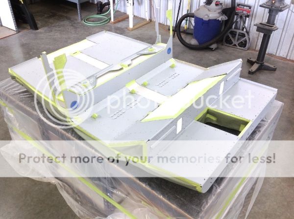

Regarding the decision to spray gun paint it or rattle can it, I glad that I went the spray gun route. Spray painting was a new experience. It generally went well. Yes, I wish the spray paint would have ended up a bit smoother (i.e. I think the root cause of this is overspray). But, it is my belief that by spray painting I got better coverage than I would have gotten with rattle can, that it turned out better than if I had used a rattle can and allowed me to gain a better understanding of spray painting (i.e. I had no prior spray painting experience).
I selected the Sherwin Williams JetFlex WR because of its low fumes (i.e. my house in a residential area and I painted it in my garage) and recommendation of others. I would use it again. I diluted the paint 17.5% (i.e. it was in the middle of the recommended 10 ? 25%).
Trying to get the standard color chart for JetFlex WR from Sherwin Williams was not successful. After multiple requests on the Sherwin Williams website, they finally sent me the standard colors for all of their paints EXCEPT JetFlex WR. So, a phone call to them, explained what happened and they said that they would send it. It never came. I finally got the standard color chart from the distributor in Ohio.
Yes, I used the recommend Harbor Freight HVLP gun. The first one had to be returned. It would not come apart to be cleaned. The second one didn?t want to come apart either. But, the store manager finally got it apart.
Building the paint booth went well. One inch PVC pipe made a good structure that the plastic was wrapped over. I would have liked the ?door? for entering and exiting to have sealed better. I had two twenty inch fans with furnace filters in front of them pulling the air out. It is not clear how much air flow is right amount. Does more air flow do a better job of removing the over spray or does it spread it around more? In hindsight, I wish I had run the fans on high rather than low. Finally, pressing some of the PVC pipe connections together rather than gluing them worked well and allowed the paint booth frame to be taken apart so that it could be stored in my attic.
My path to learning to spray paint was to use scrap pieces of aluminum, advancing to internal inspection covers that run down the center of the fuselage, then onto the baggage compartment skins, then the seats and then finally the interior of the fuselage.

8. I setup the spray gun by allowing maximum paint flow, adjusting the spray pattern to what was designed and finally the air pressure to what gave a nice spray pattern.
9. I went away from the Harbor Freight filter / dryer to its large pressure drop when the spray gun is flowing air and its length. I switched to a filter dryer from Lowes that is the size of a small orange.
10. Purchasing multiple quarts at one time rather than a gallon made it easier to stir the paint and minimize the time that it was open.
11. Cleaning the gun right after spraying kept the gun from plugging during the next use. Unfortunately, during drying of the spray nozzle with an air hose it slipped out of my hand and was damaged. Efforts to purchase a replacement spray gun at the local Harbor Freight has not been successful. Of the 7 in stock, 5 wouldn?t come apart to be cleaned and 2 came apart at the wrong location.
