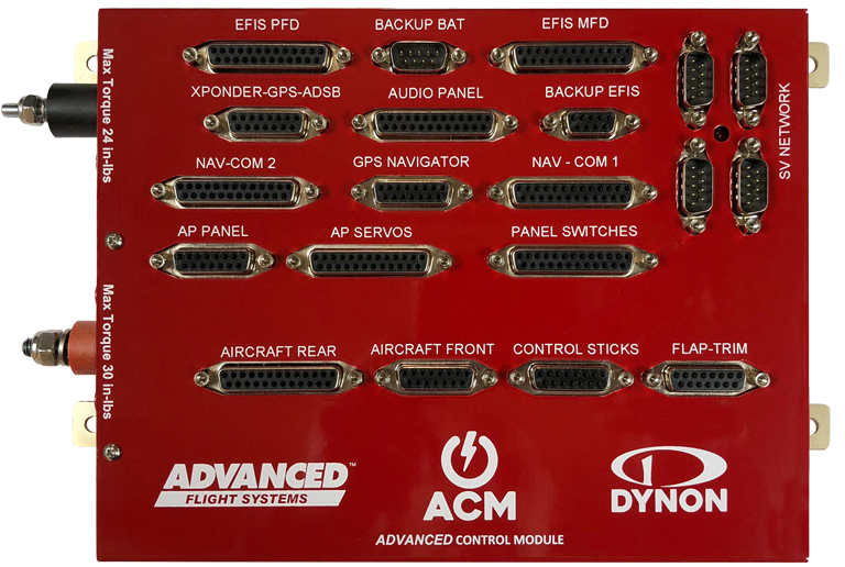

Marvin - perhaps to further clarify some of the comments above...
Vertical Power is about... POWER control. Power in, power out, power switching.
The Advanced Control Module is about all that, PLUS interfacing your EFIS devices, radios and other equipment. The ACM is the "glue logic" that allows one box to talk to the other without you having to do a custom wiring harness from one box to another.

The Advanced Controls module seems slick, but does it truly offer electronic circuit breaker capabilities (the real benefit of the VPX)?
Would be glad to hear it does, though haven?t seen that clearly specified. I see what is automotive style fuses but no mention of ECB?s.

Yes they do. Dynon page link to the Advanced Control Module with ECB's. Started shipping in March by AFS FB post here.

The AFS module with the electronic circuit breakers is kind of like the VPX and the Approach Fast Stack rolled into one box. It doesn?t have the flexibility of the Fast Stack or the features of the VPX, but it is a good option for what it does, and for a panel that is going to use the instruments that it is designed for, it should work great for you. However, already having the VPX helps you to keep on down that road.
The AFS module with the electronic circuit breakers is kind of like the VPX and the Approach Fast Stack rolled into one box. It doesn’t have the flexibility of the Fast Stack or the features of the VPX, but it is a good option for what it does, and for a panel that is going to use the instruments that it is designed for, it should work great for you. However, already having the VPX helps you to keep on down that road.
As someone that has extensive experience with all three units I would be interested in what flexibility and features you think the Advanced Control Module (ACM-ECB) is missing?
The ACM is available in two different versions, fused or electronic circuit breaker. The fused version uses lighted ATO style fuses for circuit protection. The electronic circuit breaker “ECB” version has internal circuit current monitoring and will shut off a circuit if the current is too high. With the ACM-ECB you can monitor the current of each circuit and reset any tripped circuits from the EFIS. The ACM is the main power distribution center for the aircrafts electrical system. The avionics, headsets, aircraft lights, autopilot servos, trim servos, flap motor, control sticks and panel switches all get connected to the ACM. Using the ACM with its plug and play features vastly simplifies an aircraft’s wiring and troubleshooting. The ACM also makes future upgrades extremely easy. Want to add an IFR Navigator in the future? No problem, just plug it into the ACM NAV-COM and GPS NAVIGATOR plugs. The complicated and time consuming (Audio Panel, GPS RS-232 data, NAV ARINC data and GPS ARINC) wiring is already done.

When you are comparing pricing don't forget that the ACM includes the SV-ARINC module ($475), SV-NET-HUB ($50) and does not require the VPX license ($275) for a total savings of $800
The ACM-ECB can be purchased with the harnesses, email [email protected] for a package quote. The module is priced at $2,750 in the package.
