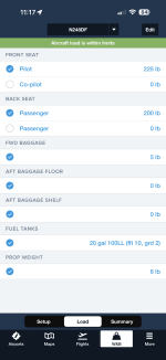

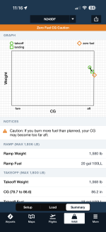

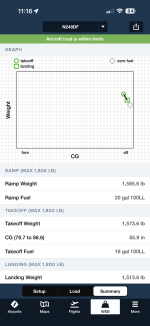

Searched all the "flywheel" threads and couldn't find anything about adding weight to the flywheel. Obviously, most folks want to get a lighter one, but in my case, my 8 is very light with a Catto prop. Of course, putting on a CS prop would be ideal but it's not in the cards. I can only find one guy who sells any "solution", in the form of a 5.6lb ring of stainless steel that bolts on.
I created a station at 16" in my Foreflight W/B to add 6lbs (accounting for hardware), and this definitely moves the CG to inside the envelope when wanting to fly with a buddy in the back. Not sure if this is perfectly the same as adding the weight and reweighing the airplane given that this is a specific weight at a specific station, not just the weight blended into the weight registered on the wheels scales. Also not sure if adding that weight the flywheel will adversely affect performance of the engine to negate this idea. The airplane also has the EarthX battery in the tail, so moving that forward to the firewall, would further improve things.
For reference:
Weight and Balance:
Right wheel: 480lb, 68.75
Left wheel: 490lb, 68.75
Tailwheel: 60lb, 251.06
Total: 1030Lbs
CG: 79.37
Photos are the load with and without the 16" station.

I put your numbers in a spreadsheet. You are well within the CG envelope with a 225# pilot and 200# passenger. IMG_0747.png
